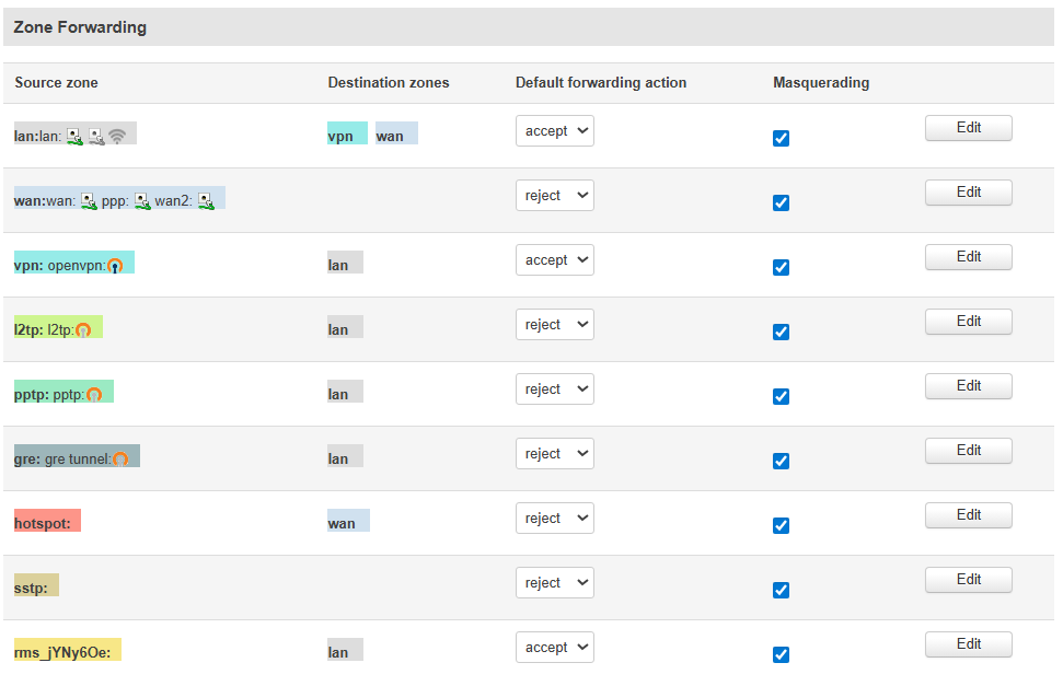

Could you confirm that Masquerading is enabled for the firewall zones under Network → Firewall → Zones? (Will be in General Settings for older firmwares)
Refer to this post for more information: RUT906 LAN Access from another subnet on a static route - #5 by MatasR
Masquerading will do a kind of NATting where it’ll translate the traffic going to the PLC so it looks like it’s coming directly from the router itself (basically LAN-To-LAN).
Let me know if this helps,
If your OpenVPN tunnel is established successfully on the Teltonika RUT950, but you cannot ping the router or the PLC, then the issue likely lies in routing, firewall rules, or VPN configuration (including IP forwarding/NAT).

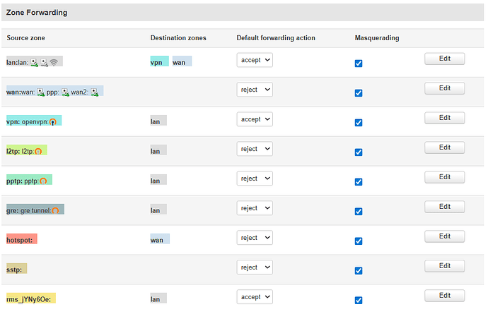

I still get the same problem even though I enabled the masquerading
