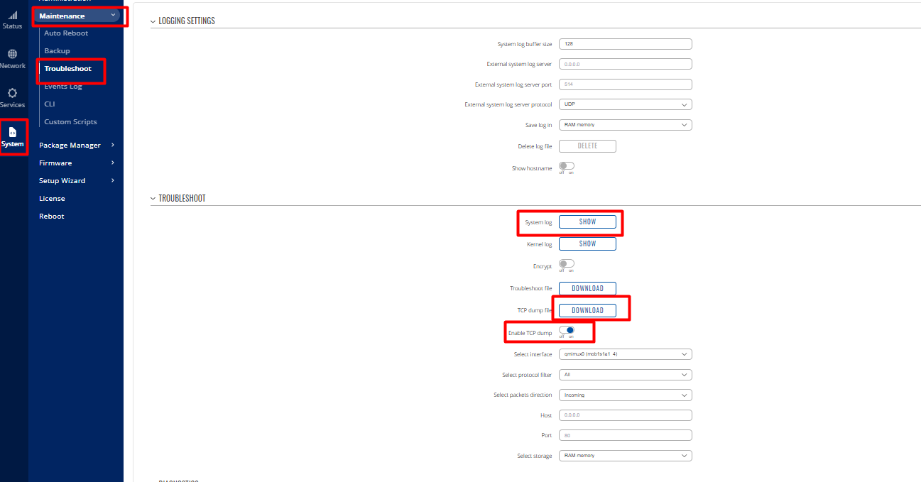

  3. You can also check for incoming traffic requests with the help of TCP Dump and requests from System Log
