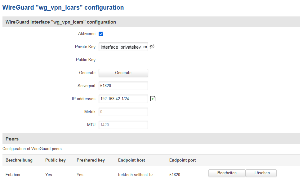

On the RUT950 I configured like this:
Hi …
At first glance, in your wireguard config, you have have given the Fritzbox a port of 56406 but you have told the RUT950, that its Fritxbox peer is listening on 51820
Apologies if you are familiar with Wireguard already but as Wireguard is routed, you will need three different subnets - the fritzbox side, the RUT950 side and one for the WireGuard tunnel.
I think your Wireguard tunnel IP settings are the same but they need to be unique at both ends but on the same subnet, one that isn’t currently configured on your end networks. So for example, you could make your fritzbox [Interface] > Address = 192.168.88.2/24 and set your RUT950 [Interface] > Address = 192.168.88.3/24 … assuming that the 192.168.88.0/24 subnet is currently unconfigured/unknown on the networks at both ends.
Start off with a low MTU setting both ends, say 1280, to ensure some stability whilst testing, then incrementally adjust upwards when happy.
I myself only started using wireguard in the last 2 weeks, so a newbie at its configuration but it works for me.
Mike

I corrected it now and the fritzbox shows a connection now. But I cannot access the router anymore. Not from local clients nor fritzbox clients and vice versa. I think that applies now for your IP subnet explanation.
