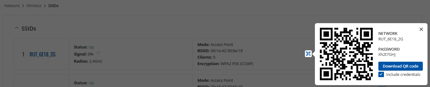

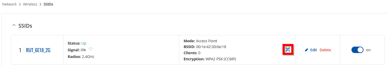

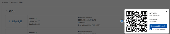

  2. Once successfully logged in, navigate to Network → Wireless → SSIDs, and click the small QR code icon.
  3. In the pop-up window, you can generate a QR code for quick access to the Wi-Fi network as you desire.

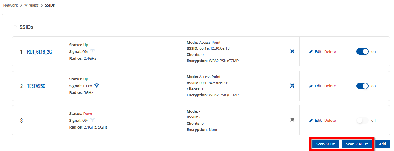

If I misunderstood, and you want to connect your router to the campground’s Wi-Fi, you can do it in the same location (Network → Wireless → SSIDs) by scanning the 2.4GHz and 5GHz networks and connecting to the desired Wi-Fi network.
