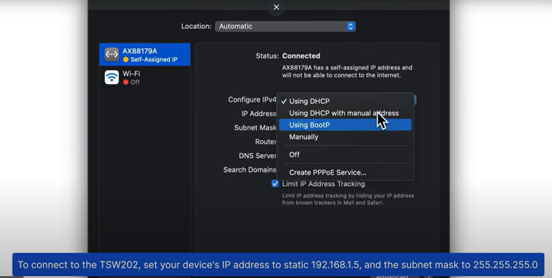

As the TSW202 QSG suggests, you have to set your computer to a static IP of 192.168.1.5:
Here you can find the QSG: QSG TSW202 - Teltonika Networks Wiki
