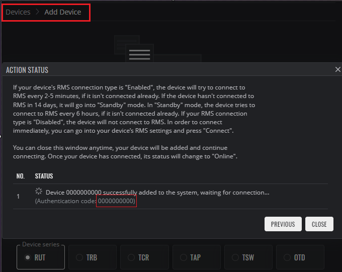

Where do I obtain the authentication code?
After entering the device’s IMEI, MAC address, and password, the authentication code will be displayed in a pop-up window:
Additionally, the code can be copied by clicking the ‘!’ button in ‘Management → Devices’ next to the device you are attempting to connect:
