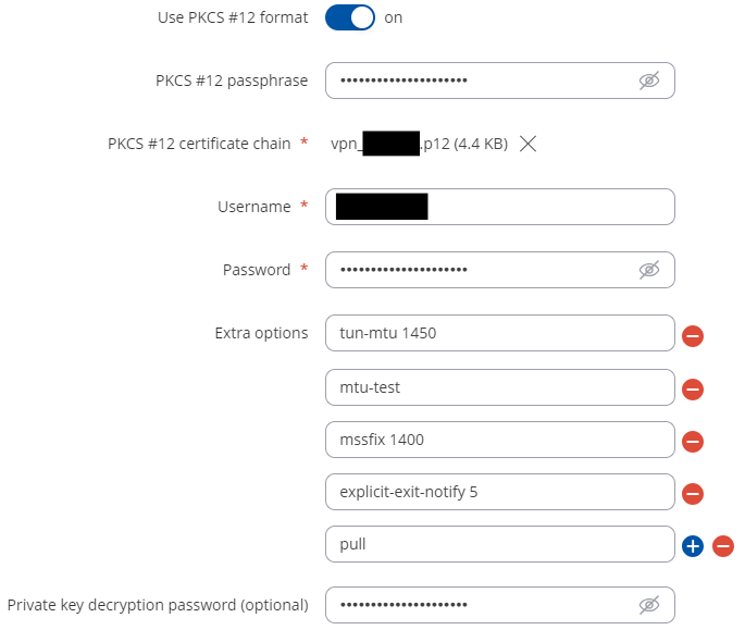

I have a new RUTX50 running firmware 7.07 with four OpenVPN client configs created manually, not from OVPN file. Recently I noticed I’m unable to save changes to any of the configurations. Whether I’m trying to change port number, extra options, or certificates, I can make the changes but clicking the “Save & Apply” button has no effect and my only option is to close the screen, at which point I get a warning that unsaved changes will be discarded.
I also upgraded to firmware 7.08 today hoping that would fix it, but no luck. Same problem exists. I can create a new OpenVPN client configuration and edit that but the existing ones appear locked. How can I fix this? I would rather not delete and recreate because I already have firewall rules and LAN interfaces configured to use the tun_c_** interfaces created.

Could you please take a screenshot of your configurations and any errors you encounter? This will help me better understand the problem and attempt to replicate it.
At this point, whether I make changes or not, “Save & Apply” appears available to click but there’s no visible response to clicking. My only option is to cancel and discard.

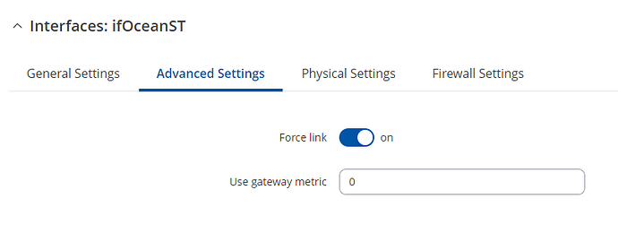

Here is the LAN Interface created using the physical tun_c_OceanMST interface.
