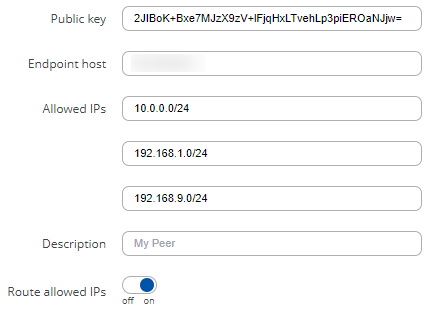

What device/service is acting as the server for WireGuard? Depending what IP address you’re trying to reach, whether it’d be the IP that the RUT gets from the wireguard server, 10.0.0.2/24 for example, or the LAN IP, which, for example, can be 192.168.1.1 - you’d need to fill the Allowed IPs list, here’s an example:
As you can see, not only is the WireGuard IP added into this list, but also the remote LAN network & the local LAN network IPs are here.
This image was taken from this particular example, which might come in handy for you: Wireguard Peer To Peer Configuration example - Teltonika Networks Wiki
