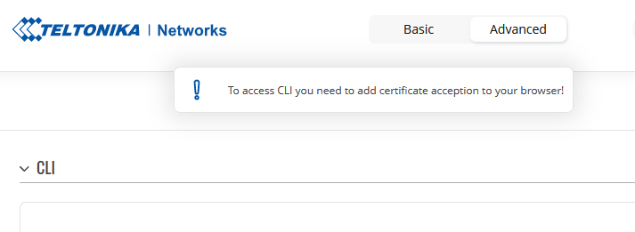

Cannot access CLI when remotely connected
This topic has been raised some time ago even before this community was opened, but I have not seen any solution for it. There has also been a bad advice of disabling the https to overcome the error:
“To access CLI you need to add certificate acception to your browser!”
This is a well known bug and someone also said that was going to be solved in a future fw release, but it is still there and I cannot access the CLI from the webcli when in remote connection.
Anyone came up with a solution or a workaround that doesn’t disable security?

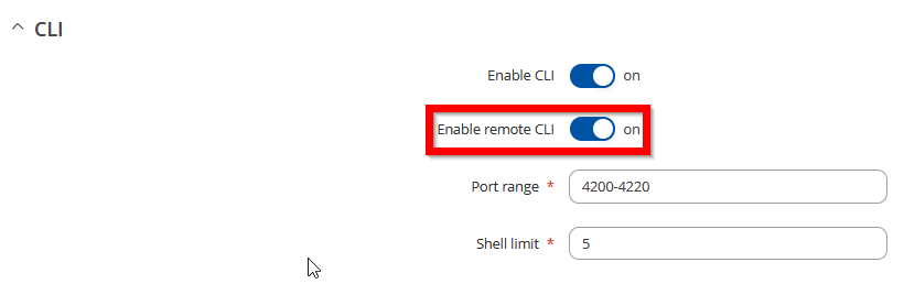

This might not be a bug :wink:! CLI access, especially in remote connections, needs to be enabled in the router’s settings. By default, it is disabled. To activate it, navigate to System → Access Control, and in the CLI section, you should find the option “Enable Remote CLI” that you can turn on.

I enabled the configuration that Marijus suggested, but I get the same exact error as before.
