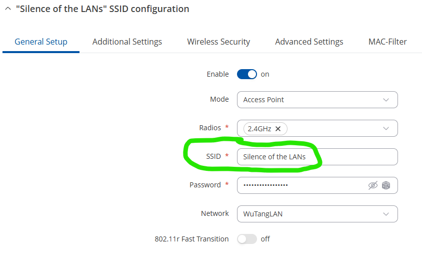

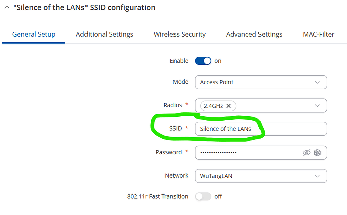

In the menu, go to NETWORK > WIRELESS > SSIDs and click on ‘Edit’.
You can then change the ‘SSID’ field into something more meaningful.
