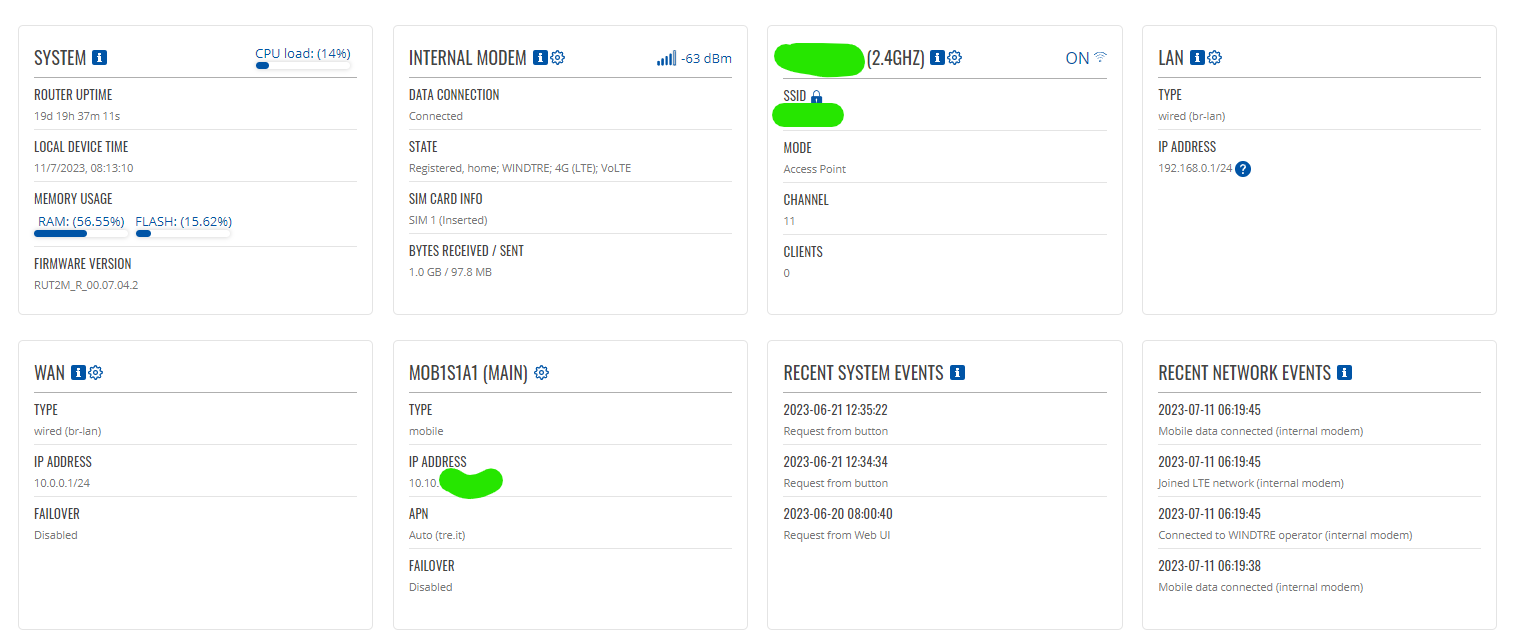

Since you can connect from the local network, but not over the internet, could you please check if you have a public IP address on your RUT241? What are the first 2 octets of the IP address on your WAN/mobile interface?
The PPTP configuration example is available on our wiki page here. You can take a look at it and check if you have configured everything as demonstrated in the article.
screen below.
MyIp website says: 151.18.x.x
Kind regards
Your mobile interface has an IP address that starts with 10.x.x.x, which is classified as a private IP address. So your device is undergoing Network Address Translation (NAT) by your service provider, and, as a result, your device is unreachable from the internet.
You can reach out to your service provider to inquire about the possibility of obtaining a public IP address. Usually, service providers, if able to supply a public IP address, will offer a specific Access Point Name (APN) that you need to input into your router to receive this public IP address.
On RUT241, APN can be configured in Network → Interfaces → General → Edit mob1s1a1 interface Disable auto APN and enter a custom APN given to you by your provider.
Then, your device should be able to obtain a public IP address, and then it will be accessible over the internet.
