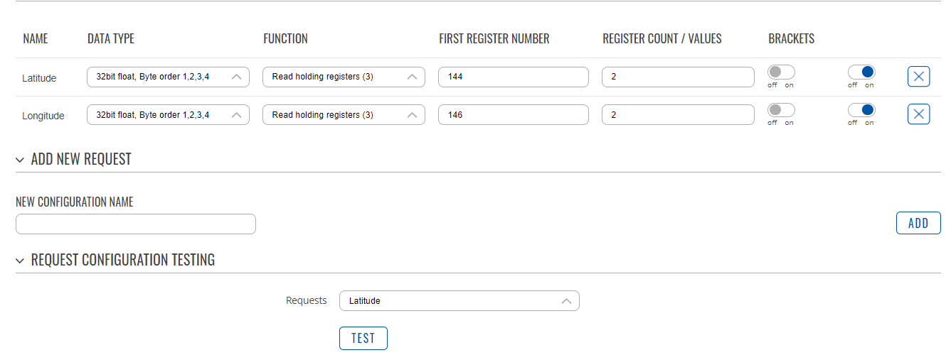

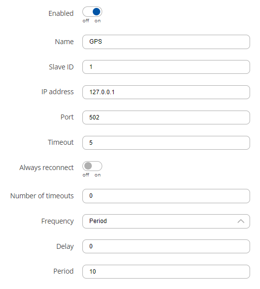

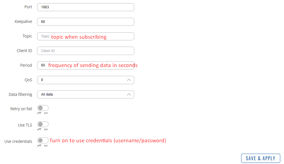

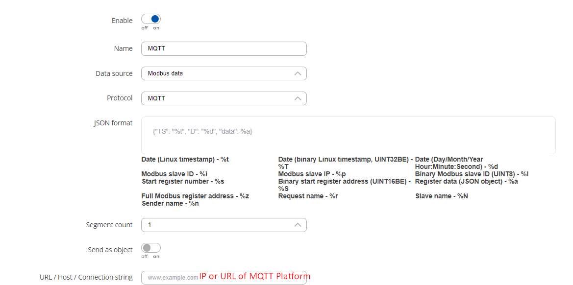

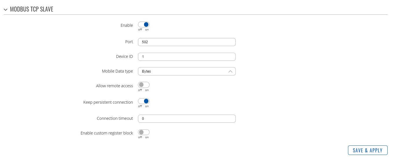

You can refer to this link for the Modbus Register addresses of GPS data. Once you pull out this GPS data, you can send it to your MQTT Server via Data to Server feature. Here are some sample configuration for the same.
Modbus TCP Slave
Modbus TCP Master
Data to Server - MQTT
