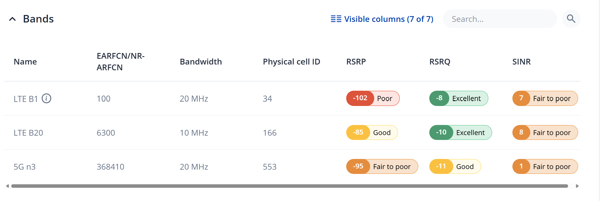

I received my RUTM30 today and immediately tried it out. I managed to get 116mbps download speed with attached RSRP, RSRQ and SINR values, and i didn’t even have the wifi antennas connected. I am impressed so far. As stated above, its not about raw speed for me, but this speed makes me trust in the benefit of band aggregation in rural areas.
Happy to hear that! Enjoy!
