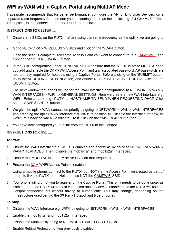

good morning, I’m in a campsite where I have to authenticate on a portal (username and pass) I configured the wireless interface but I didn’t understand where the portal appears. the encryption is none. the redirect captive portal is on. thanks
If your router is a model that has the the TravelMate package, then it could be a good idea to read up on it, decide if it’s for you, and install. All the info you need is in the Wiki or Community forum, to search for.
already read this article but no client shows the campsite authentication portal.
https://wiki.teltonika-networks.com/view/Connecting_to_a_Hotspot_WiFi_for_Internet_Connectivity
I personally have not used Travelmate, so hopefully there will be someone along who has.
I seem to remember one of the posts here showing the steps of authentication … so might be worth searching.
Did you test Travelmate with a Captive Portal before you started on your journey? If so, how is the behaviour now different from your setup tests?
No was my first try
Hi Ighinelli,
The crucial part of configuration is when connecting your router to the existing hotspot network.
When scanning to the hotspot network, this tab should appear. Leave Network as default and enable Redirect captive Portal. Device running on 7.08.2 FW.
Go to Network → WAN and verify if wifi0 will be having an assigned IP.
Now, once you connect your end device to the Wi-Fi network of the router, it should redirect to the captive portal of the hotspot network.
Cross check if any IP subnets are overlapping.
Let me know if this helps.

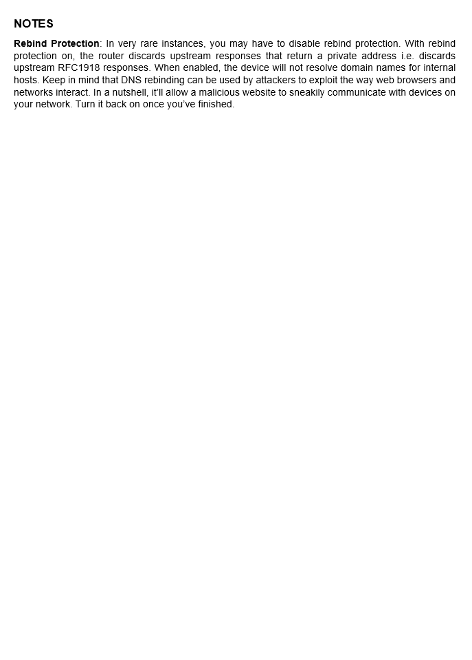

I’m also having problems with the captive portal.
I just got back from vacation and couldn’t use the campsite Wi-Fi at any campsite because the provider’s captive portal wasn’t displayed :frowning:
I’ve tried this at three different campsites…
The address is displayed but not loaded. Maybe DNS problem ?
I’ve been working with IT for over 40 years, but on vacation, I’d like a system that works without extensive configuration.
I’ve configured the app “use case: Camper” and it was a good step; I don’t want to go back…
who has an idea / solution?
System Rutx11
APP Version: Android: RutOS 1.14.11
Firmware: 00.07.14
THX
You should upgrade your firmware first, then …
