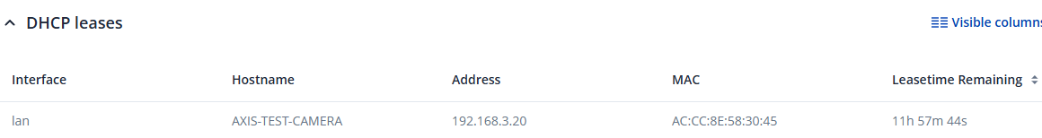

If that doesn’t work, as a manual workaround, you can edit the /etc/config/dhcp file to add the static lease. So for the camera shown above, go to the end of the file and add the lines ….
config host
	option mac 'AC:CC:8E:58:30:45'
	option name 'AXIS-TEST-CAMERA'
	option ip '192.168.3.20'

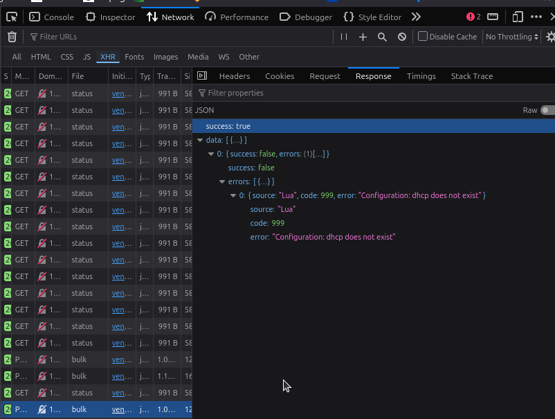

  1. via F12 browser developer menu open network tab.
  2. Reproduce problem.
  3. Copy last bulk request’s response body from network tab (it might be malformed or response could include API error) (there is possibility that no bulk was sent due to error that should be shown in console)
e.g
  1. open console tab and copy any error that happened during reproduction (the error can be very ugly as code is minified)
e.g.

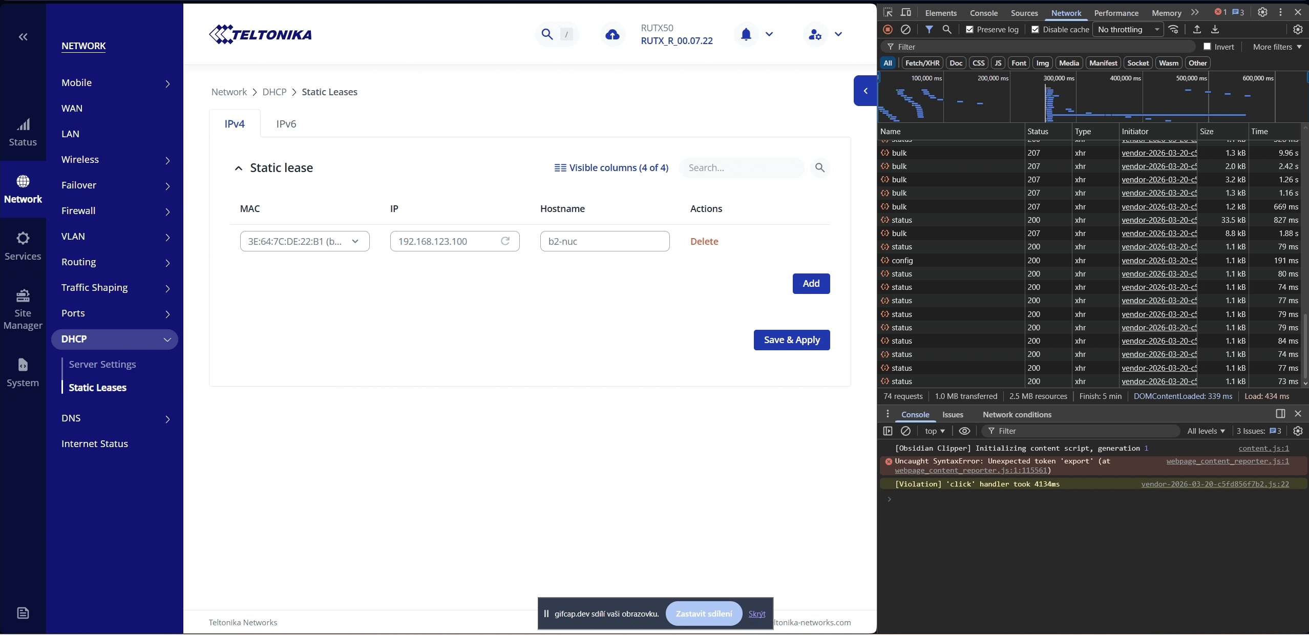

When I click the button, no network request is made; only the error message appears. Also, nothing logs to the console.
Recording 2026-04-07 at 14.27.49
When I change the MAC, it logs this error in function
isMobileBridgeIp(e, t) {
    return e.some(n => Ot.isMobileProto(n) && ["bridge", "passtrough"].includes(n.data.method) && n.data.bridge_ipaddr === t)
index-2026-03-20-c5fd856f7b2.js:16 Uncaught (in promise) TypeError: Cannot read properties of undefined (reading 'method')
    at index-2026-03-20-c5fd856f7b2.js:16:82049
    at c (vendor-2026-03-20-c5fd856f7b2.js:9:7984)
    at Array.some (<anonymous>)
    at Cn (vendor-2026-03-20-c5fd856f7b2.js:9:8074)
    at Proxy.some (vendor-2026-03-20-c5fd856f7b2.js:9:7356)
    at Object.isMobileBridgeIp (index-2026-03-20-c5fd856f7b2.js:16:81980)
    at k (app.dhcp.app-2026-03-20-c5fd856f7b2.js:1:31816)
    at e.isValid (index-2026-03-20-c5fd856f7b2.js:16:111890)
    at Proxy.validate (index-2026-03-20-c5fd856f7b2.js:18:105029)
    at Proxy.rules (index-2026-03-20-c5fd856f7b2.js:18:102297)
