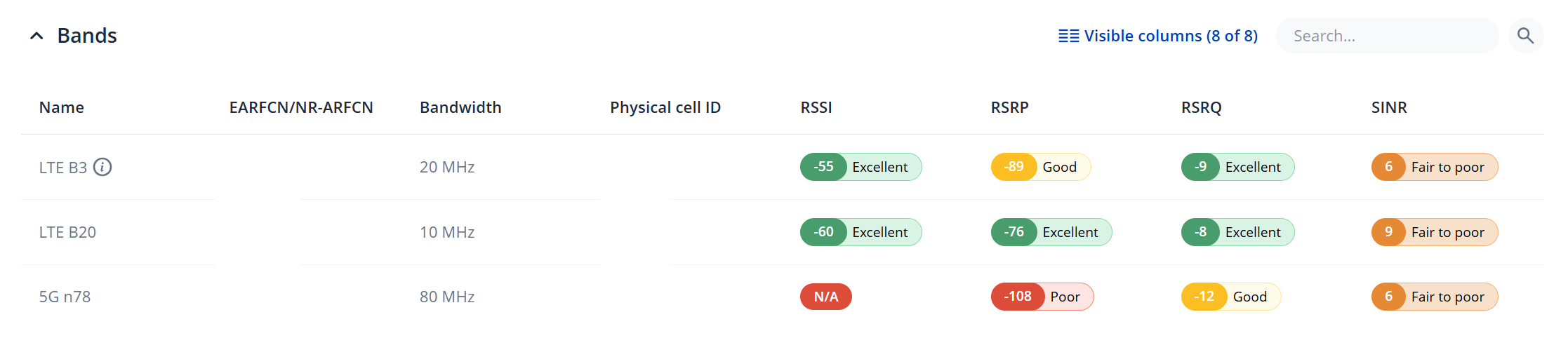

I would like to report an issue I encountered after updating my TRB501 to the latest firmware TRB501_R_00.07.22.1.
I noticed a display bug in the Status > Network > Bands menu. Specifically, the RSSI value for the 5G band (5G n78) is displayed as “N/A”. With the previous firmware version, this data was displayed correctly.
Could you please look into this and fix it in an upcoming update?

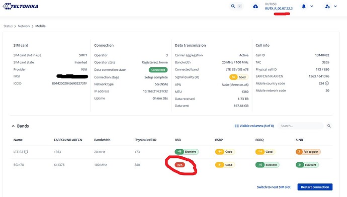

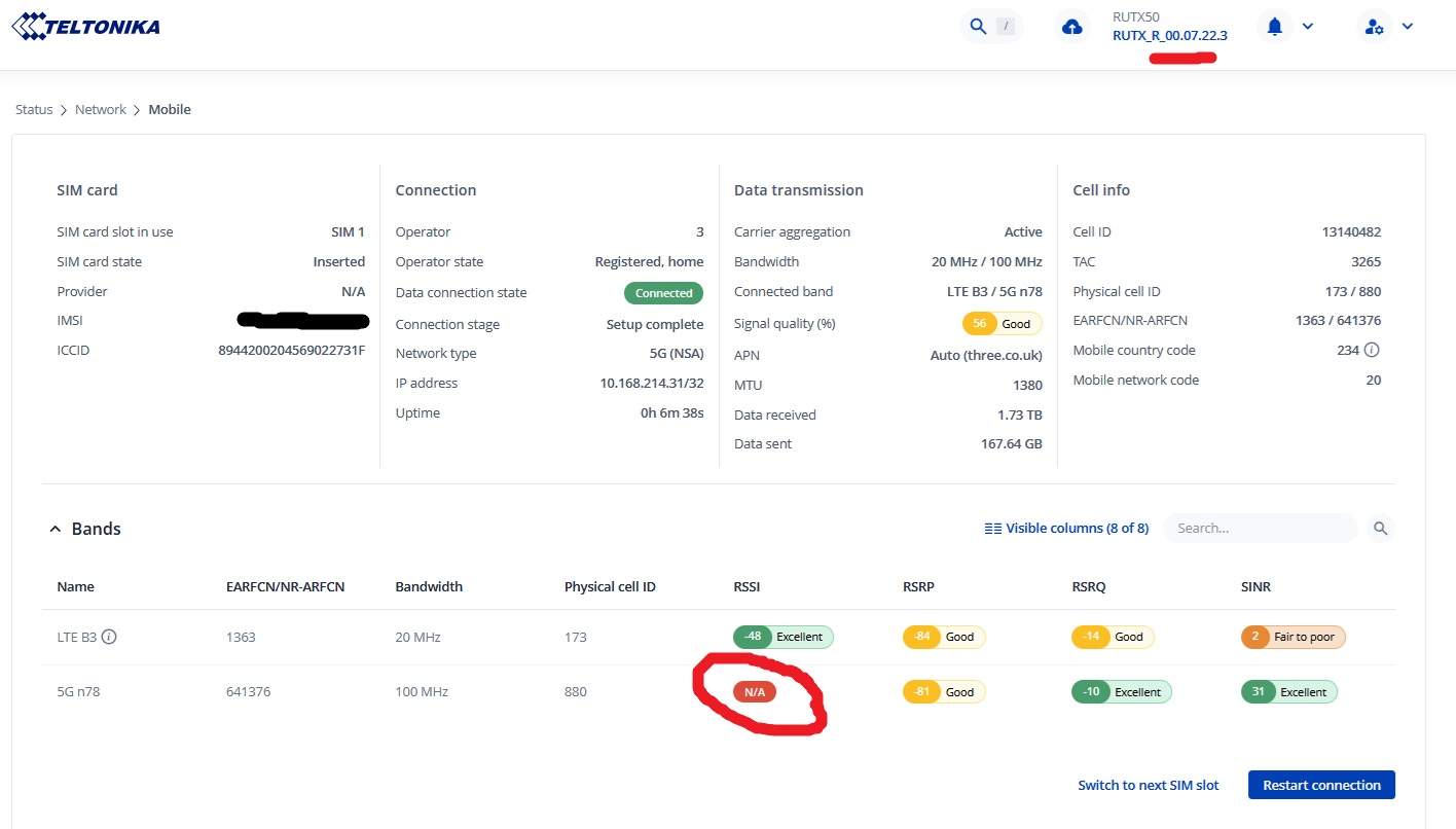

I have exactly the same problem on my RUTX50 with 07.22.1
5G n78 RSSI N/A at 100MHz, not having an impact on performance though as far as i can assertain.

RUTX50 upgraded from 07.22.1 to 07.22.3 and the problem remains.

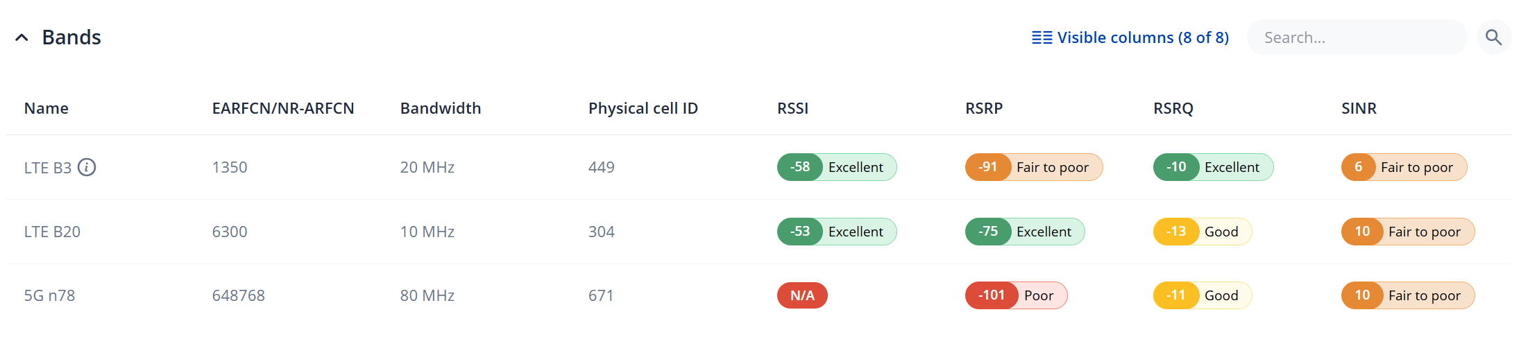

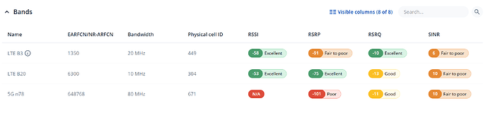

RSSI still N/A in 5G n28…
