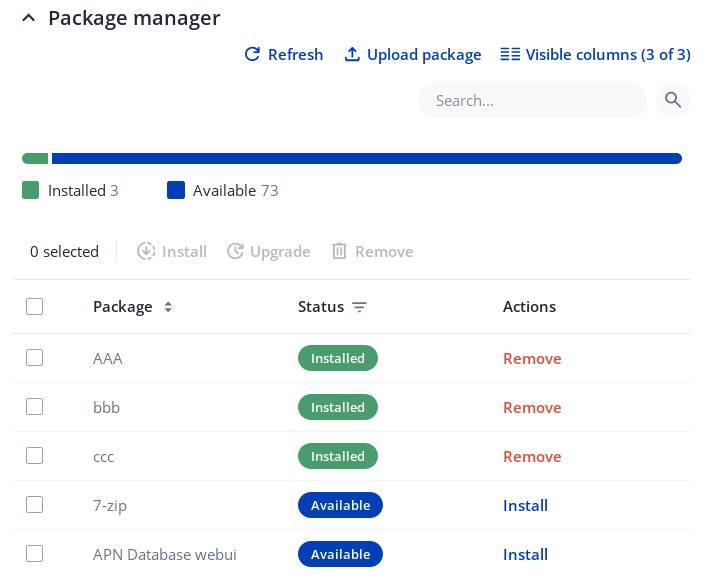

which I can upload via web interface Package Manager → Upload package. This will install the tarball and all .ipks, but when I reload the page the manager shows each .ipk as a singular item:

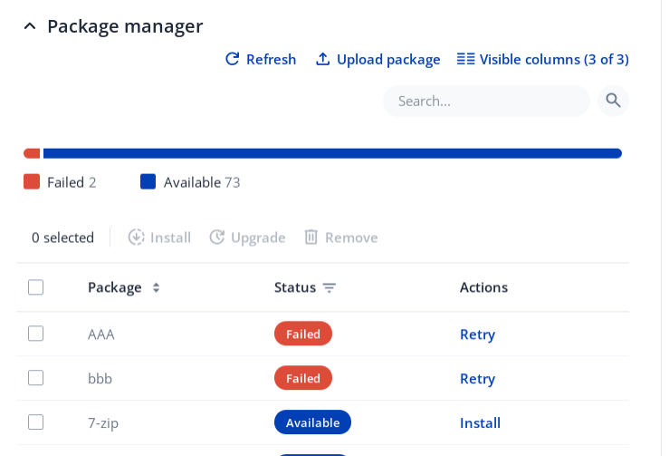

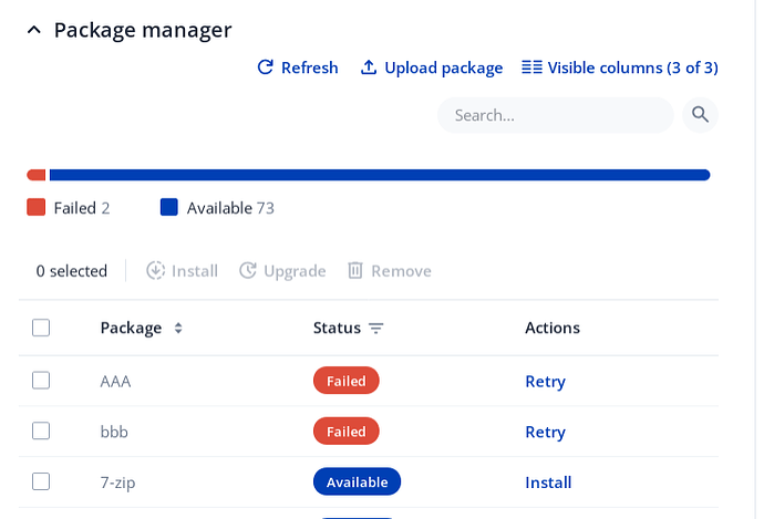

and when I select them all and click “remove”, the Package Manager will fail and end up in this state:
Sometimes I can uninstall these packages when I click “remove” in correct order of dependecies, but a real world project is a tarball with several .ipk packages and have a complex dependencies, so one by one is not very practical.
