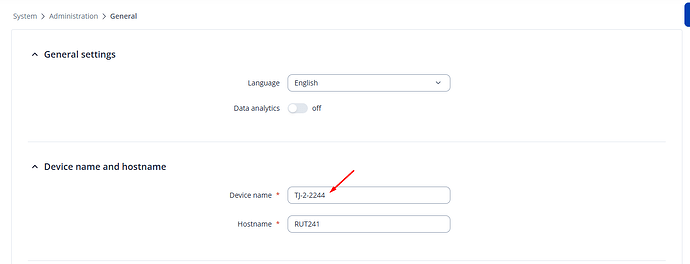

I want to send the device name, but instead the product code is sent.
Could you kindly confirm which firmware version is currently installed on your RUT241?
It’s RUT2M_R_00.07.18.3
