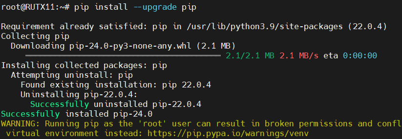

After trying to upgrade python and pip, I think pip is broken…
root@RUTX11-3:~# pip install --upgrade pip
-ash: pip: not found
root@RUTX11-3:~# opkg -e /etc/opkg/openwrt/distfeeds.conf install python3-pip
Package python3-pip (22.0.4-1) installed in root is up to date.
I was able to successfully install pip using 07.06.5:
Perhaps you could try removing it and re-installing it again?
If that does not help, could you clarify if any of the pip files exist in /usr/bin directory?
