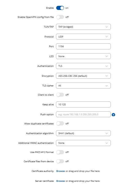

Instructions are available on openvpn.org and on the web. As an example, my client configuration looks like this (for a windows system):

And for the server on my Teltonika devices (RUT240):
