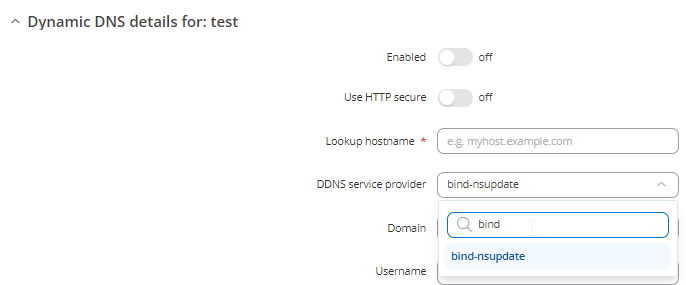

https://wiki.teltonika-networks.com/view/RUT200_Dynamic_DNS
states as service “bind-nsupdate”, but i did not find it in the list.
Is there a plugin for RFC 2136 DNS updates?
“Bind-nsupdate” should be present in the DDNS setting. The nsupdate tool (according to RFC 2136) should be installed on your system by default. If it isn’t, you can install it by running the following command:
opkg install ddns-scripts_nsupdate

I did already…
I have contacted RND regarding this issue to verify if the bind-nsupdate (DDNS service) is indeed supported on the RUT200. I will provide an update once I receive substantial information.
I intsalled the newest firmware, now i can select bind-nsupdate.
But: There is not nsupdate prog on the router. And no

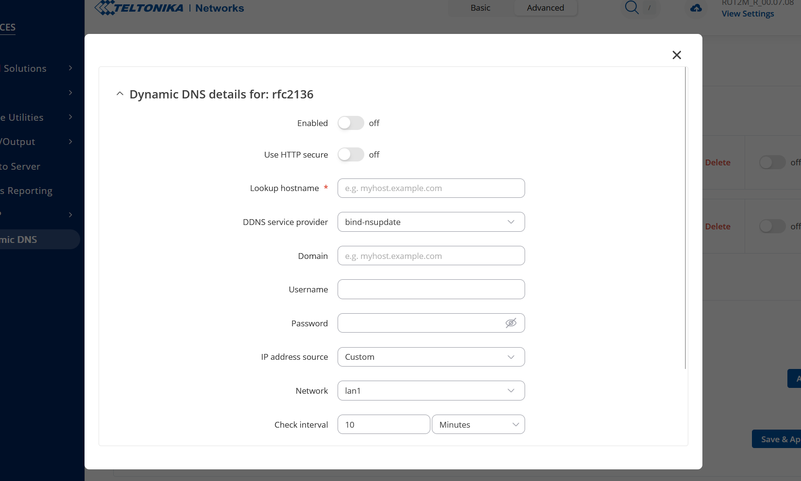

And: The form ask the wrong things, for rfc2136 update i have to enter the desired hostname and the nameserver address and port. Also the TSIG-Key and TSIG keyname. (It seems, that the script update_nsupdate.sh uses username password for TSIGname and key…)
It seems, that snsupdate is also an updater for rfc2136, but i am not shure…
I also build the firmware by myself, then the ddns module is not working in the web-interface (and of course nsupdate also missing).

Where in the web-interface I can set this "option dns_server" ?
By the way: I changed the script /usr/lib/ddns/update_nsupdate.sh to ignore "option username" and "option password", because my DNS-server did not need this. LAter I would provide a modified version of this script, if you tell me, how. This would then accept empty username/password and generate the “DATAFILE” accordingly.
Sorry I don’t know. Look at /etc/config/ddns the value isn’t present by default but you can try adding it there.
Works.
But where I can provide my modified version of /usr/lib/ddns/update_nsupdate.sh? Is there a github or gitlab repository?
The ddns-scripts package comes from openwrt try submitting a PR there. Good luck.
