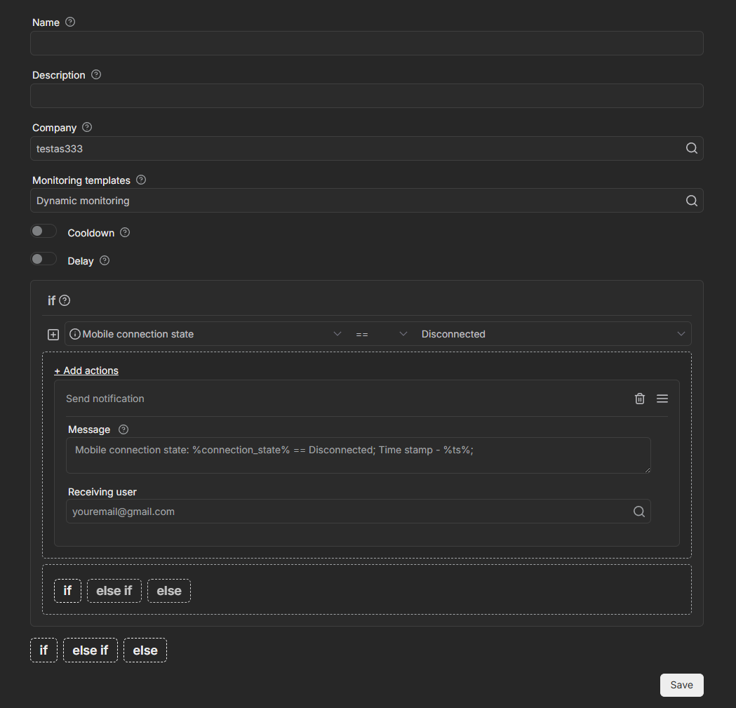

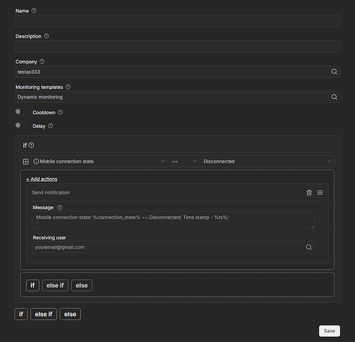

  1. I suggest looking into RMS Alerts & Automations: RMS Alerts & Automations - Teltonika Networks Wiki
A very raw example of how your alert should look like:
