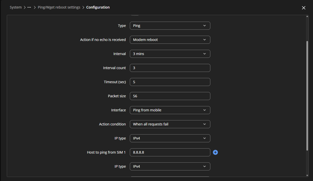

  • Go to System → Maintenance →Auto Reboot, click on edit and configure it as shown in the screenshot below.
When roaming on a private APN, a modem will often successfully register on a partner network but fail to establish the data session. Setting a rule to ping your private gateway or a stable DNS (like 8.8.8.8) ensures the mobile interface automatically restarts if data stops flowing.
