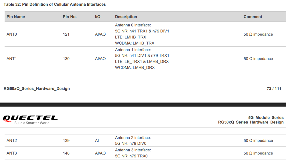

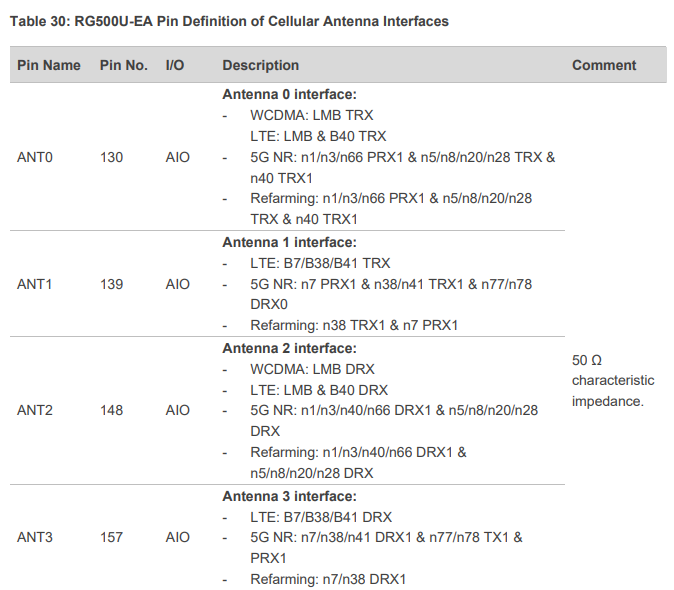

  3. The antennas are similar in general function, but for precise specifications, please refer to the modem documentation for your specific device. For example:
    RUTX50:
    RUTM51:
