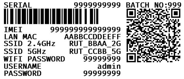

Are you positive that the default password of your device is admin01 and not a password that is randomly generated & located on the back label of your device?
Hello M,
I tried both, and neither works.
