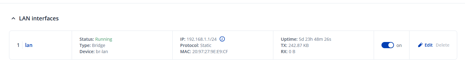

Hello Vilius,
Here are the configuration:

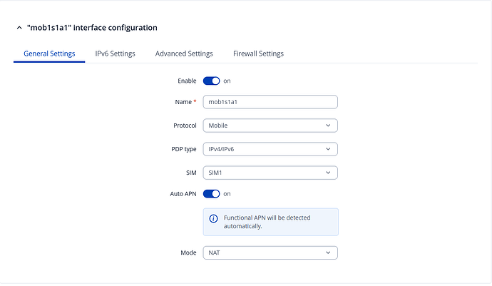

  1. LTE WAN IP (RUT2)
    • The LTE WAN interface is assigned a public IPv4 address
    • IPv6 / dual-stack is enabled on the mobile interface

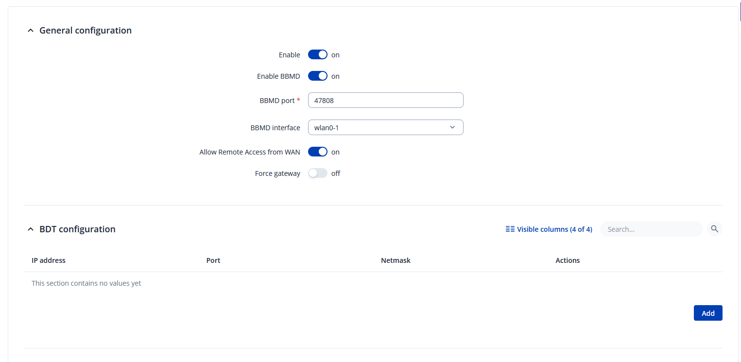

  2. BBMD Setup (RUT2)
    • BBMD is assigned to the wlan0 interface,
    • Allow Remote Access / Port Forward is enabled

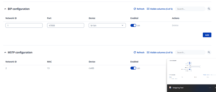

  3. BIP Configuration
    • BACnet/IP port: 47808 (default)
    • BIP is currently bound to the br-lan (LAN) interface
  4. YABE FDR Configuration
    • RUT2 IPv4 WAN address is used for FDR registration
    • YABE is operating in IPv4-only mode

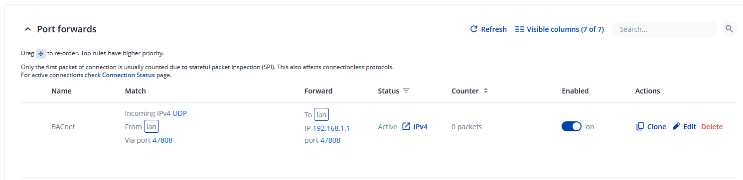

  5. RUT1 Port Forwarding
    • UDP port forwarding from WAN to the YABE PC is configured
  6. Packet Capture (on PC connected via LAN cable to RUT1)
    • Destination IP: RUT2 IPv4 WAN address
    • Destination port: 47808
    • Protocol: IPv4
    • Capture location: PC (connected via LAN to RUT1)
Best regards
