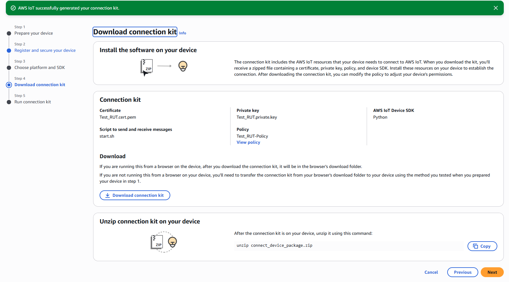

This is a screenshot of the AWS IoT environment.
