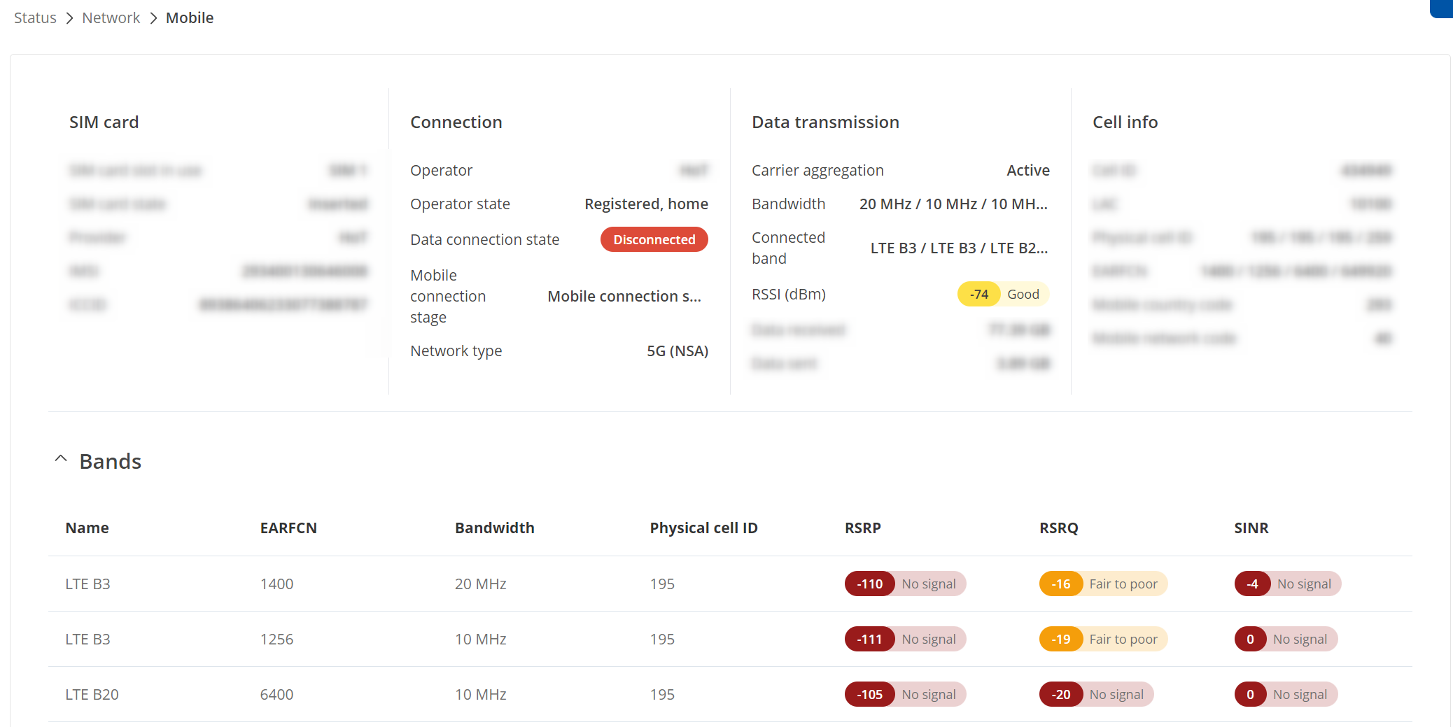

I’m mainly referring to the connection data showed in the RutOS interface, although the mobile network is “Disconnected” it still shows the signal strength, is updating RSSI number and Bands RSRQ, Carrier Aggregation status is still marked as “Active”, Cell info is still present. The physical connection bars LED indicator, on the router itself, still shows connection strength 2 bars…
Mobile data connection is a part of your mobile connection. Even if it’s turned off, you can still use basic services like SMS and calls, but no data connections should be present.
