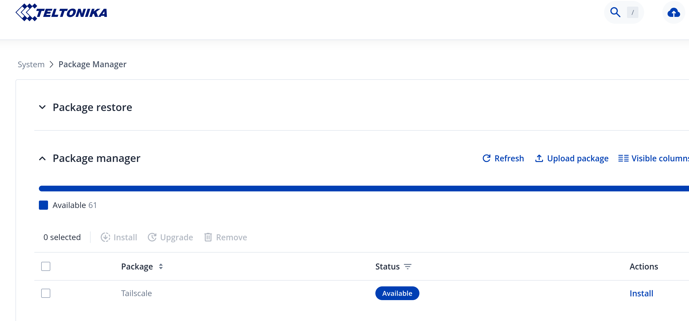

It is possible. I would recommend Teltonika RUTX50 as thats what i have and it works super stable. I have several VPN tunnels configured and accessing my internal network. Since your provider is using CGNAT, that means, as you said, port forwarding is not possible. In this case, you need to use overlay VPN like Tailscale. This is available on Teltonika devices as additional package that can be installed using their software repository.
Once you create your account on Tailscale website, and configure Tailscale client on your Teltonika router, you would be able to achieve what you described. Hope this helps.
