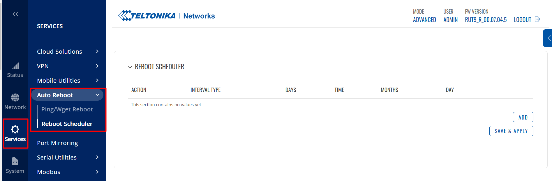

It is possible to achieve daily reboot on a RUT950. It has a functionality dedicated for this, it is called “Auto Reboot” (straight forward)
Just navigate to Services - Auto Reboot.
From there you can configure it accordingly based on your needs.
One is via Ping Reboot, where if it fails to ping a certain IP address such as the Google DNS Server (8.8.8.8) it will automatically reboot.

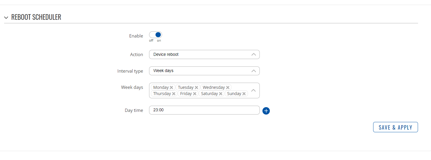

Second is via Reboot Scheduler where it is pretty much your requirement.
