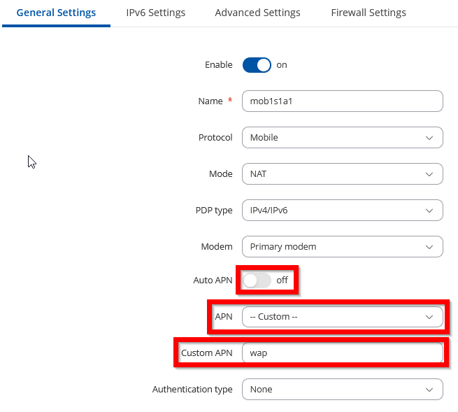

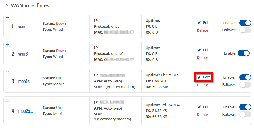

I’ve checked the apn.db, but couldn’t find the APN you need. We update our APN database based on Google’s APN database. This means that if the required APN is not in Google’s database, it won’t be in ours either. As soon as it gets added to the Google APN database, we will update our database accordingly. However, this can be solved temporary by disabling AUTO APN and manually entering your APN or selecting one from the carrier-provided options. To do this on our routers, navigate to Network → WAN and click “Edit” for the selected mobile WAN interface.
In the new pop-up window, disable the “AUTO APN” feature and choose an APN from the dropdown menu or enter it manually.
Following these steps should resolve your issue.
