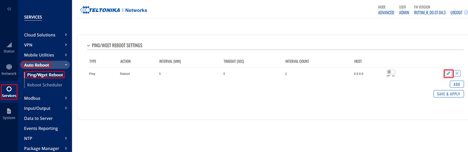

To reboot the device when pings to a specific host fail, you can use the ping reboot functionality available in Services → Auto Reboot → Ping/Wget Reboot. You can edit the existing rule or create a new one and configure it to ping a device in LAN, and in case of failure, reboot the device. You can find more information about ping reboot functionality on our wiki page here.
Here is a step.
login device’s WebUI and you should turn on “Advanced WebUI” mode.
Go to Services → Auto Reboot → Ping/Wget Reboot → edit
Enable the default rule.
