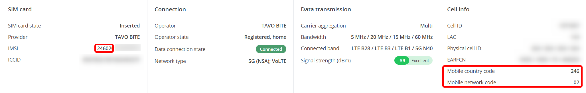

When the device is registered on home network, the first 5/6 numbers of IMSI will be MCC+MNC combination:
