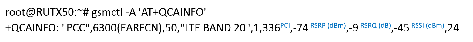

This works on a RUTX50, might be worth a try if the returned data is what you’re looking for.
