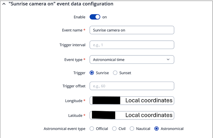

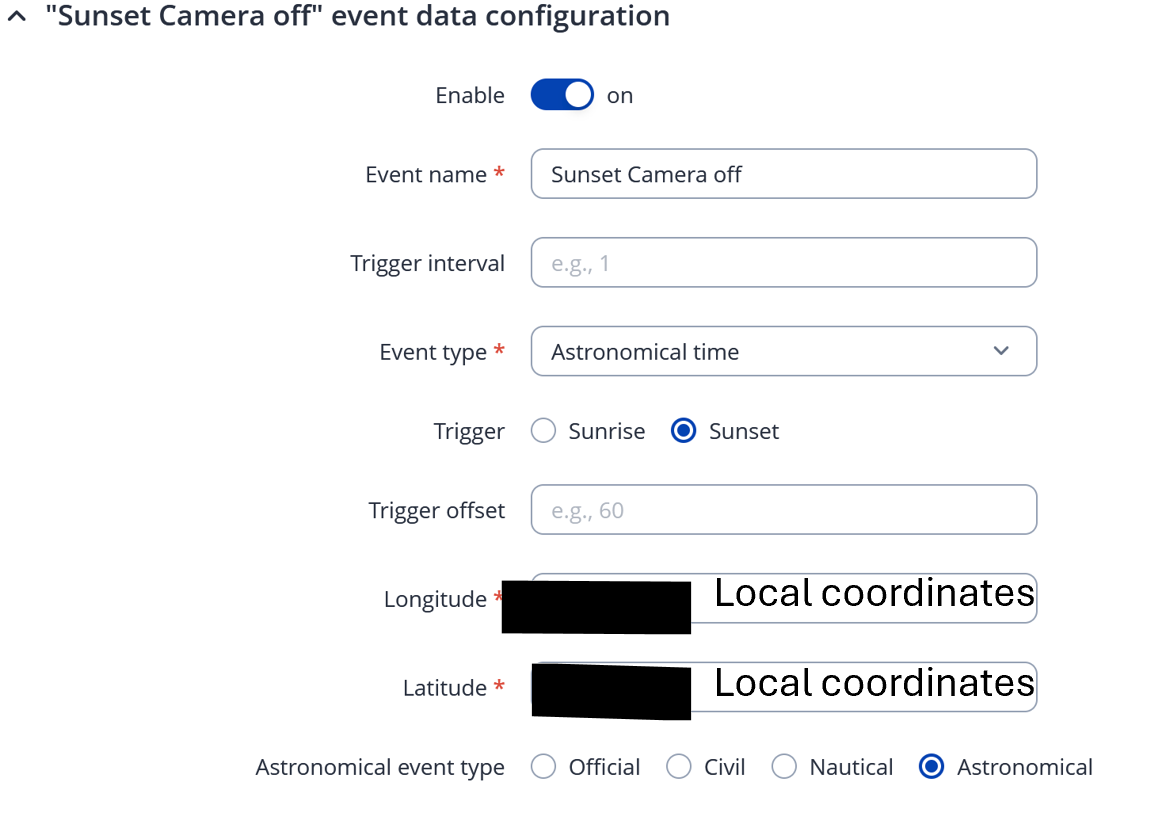

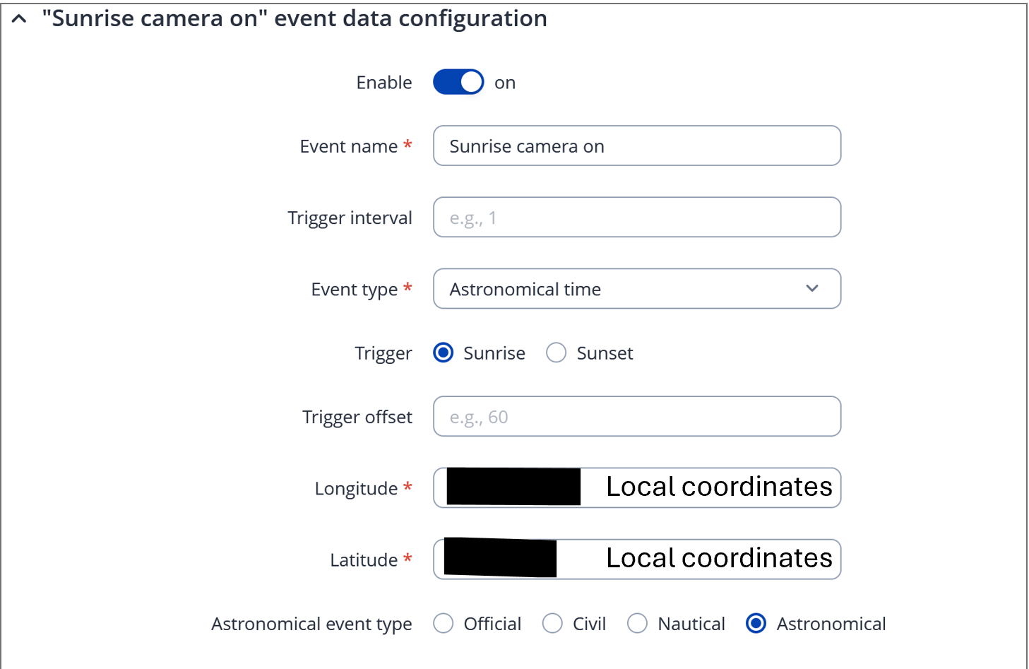

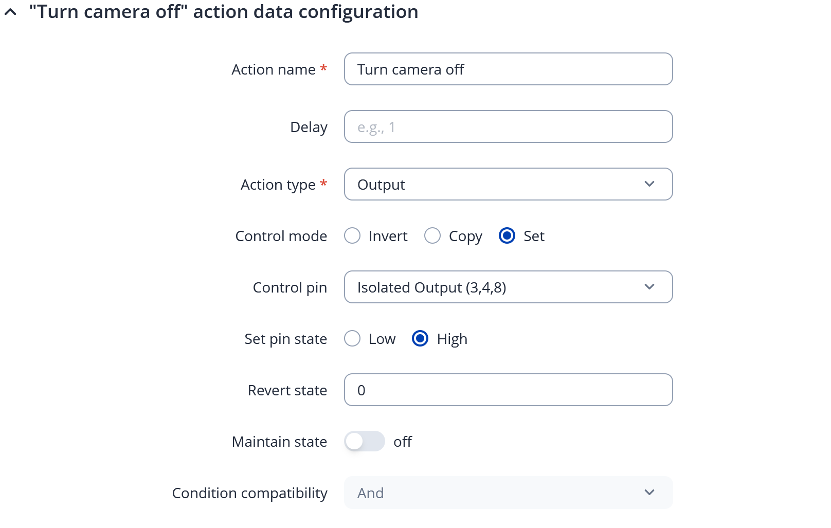

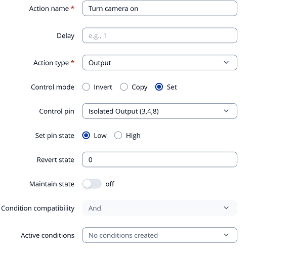

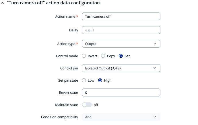

I’m attempting to configure an event using the event juggler to control power to a camera based on daylight hours and although I believe it is set up correctly, the event fails to trigger. Here is how I have it set up:
  • Time is set by our network NTP server and device time/date are correct
  • The event has been left running for several days with no trigger, also confirming it is not just a timing issue.
  • The cellular connection is on a custom apn that never hits public internet, which I’m starting to suspect might be part of the issue.
  • As a test I created a time event that controls power to the camera at a set time and it functions properly and at the expected time, so I know that the i/o is configured correctly and there is no time issue.
  • event log does not show any event triggers
Am I missing something?
As an aside, I notice when I set the time zone to the local time, save, and navigate away, the time zone will revert to gmt +#. It seems like this won’t take daylight savings time into account. Is there a solution for this?

Currently in my location astronomical twilight is around 9:30 pm, so it should still trigger. I have also tested the event on civil and nautical twilight, which are both earlier and have not had a trigger in either configuration.
As an additional data point I set up another RUT956 with identical configuration except this one was capable of reaching the internet. The event still failed to trigger. Unless I’m missing something key, I don’t think the astronomical time event is functional.
