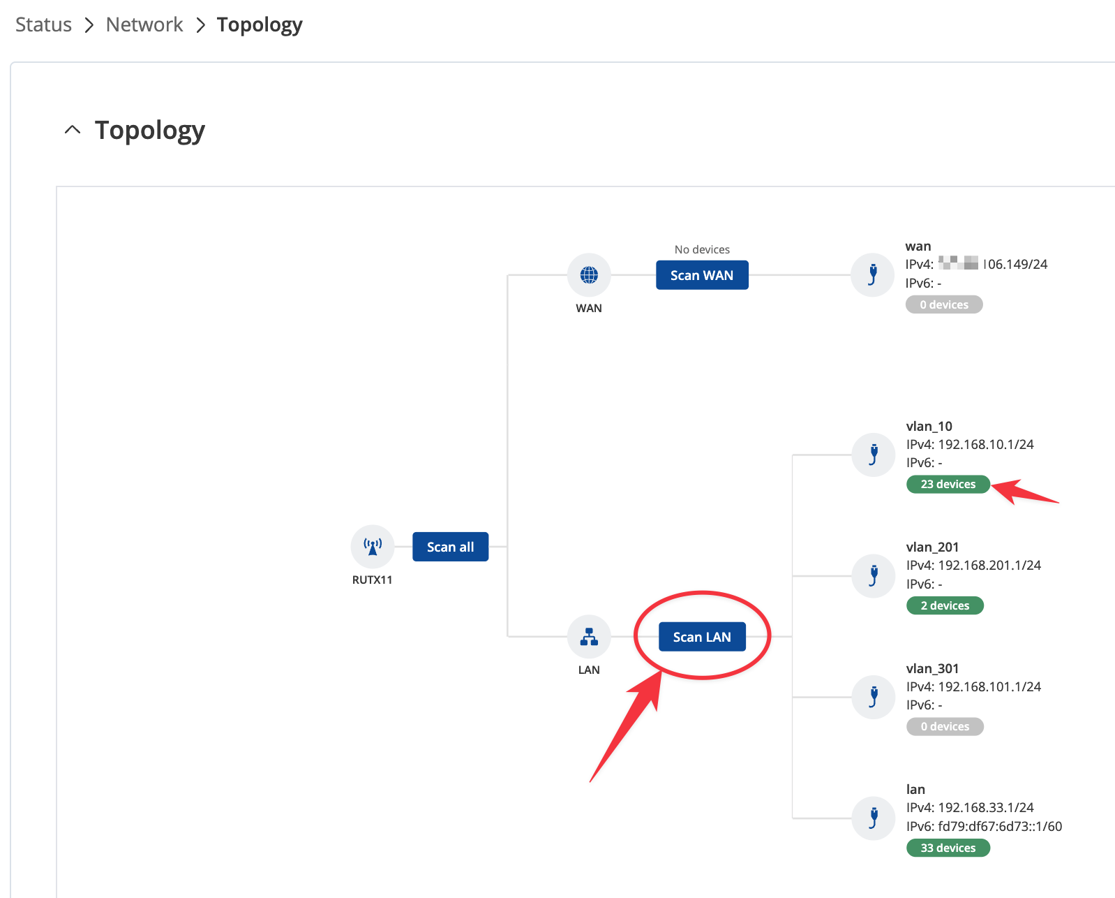

Ok, in that case, may I ask how the “Scan LAN” function is implemented? It seems the device has the capability to scan the local network segments. Maybe I can use this in a script or call it using the on-device API somehow?
The “Scan LAN” function on Teltonika devices is implemented using an ARP scan on the selected interface(s) based on the subnet range. This process detects active devices connected to the network by sending ARP requests and collecting responses, which allows the device to identify hosts by their IP and MAC addresses.

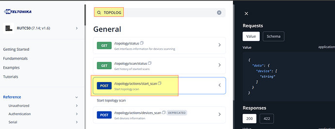

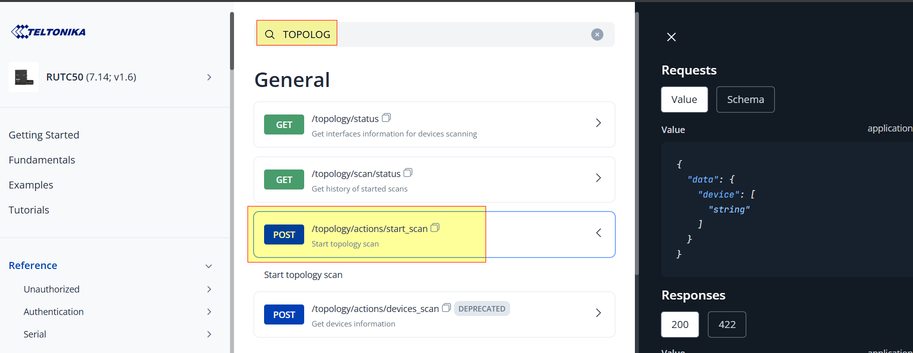

The API endpoint for the topology scan is this one (see screenshot)

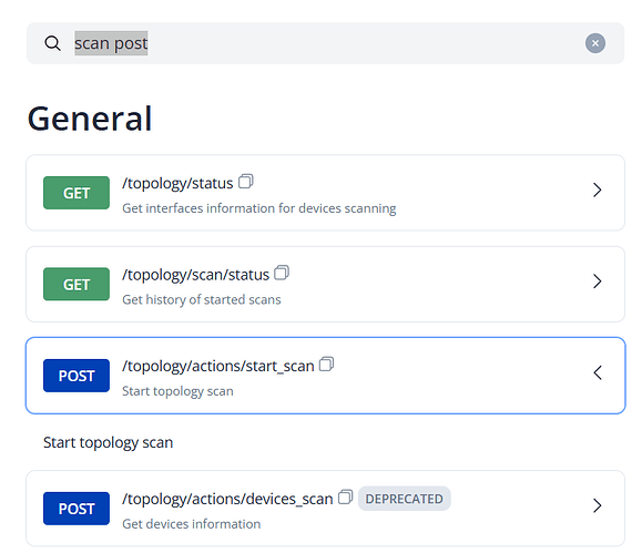

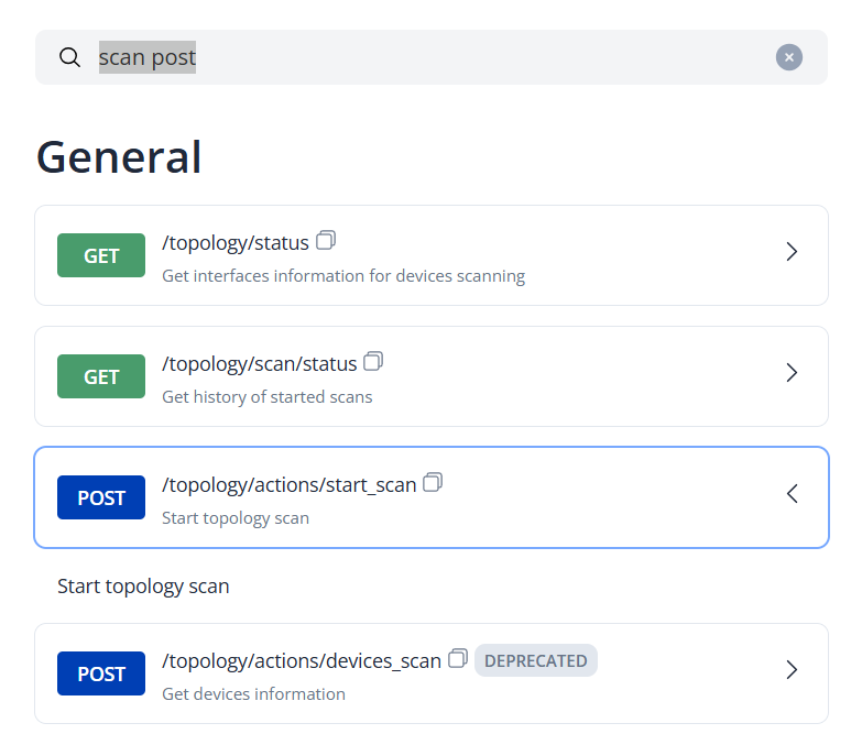

If instead of post, you are looking to Get information, you can find the endpoints here :
You can find the rest of the API commands and instructions here: https://developers.teltonika-networks.com/
