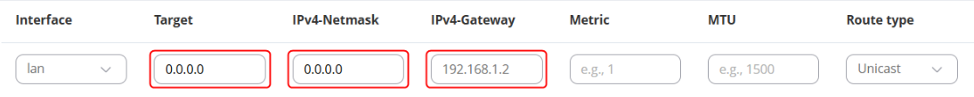

Repeat these same POST requests on each mesh node. If a mesh node requires internet access, you will also need to configure a static route accordingly.
On the IPv4 Gateway – enter the LAN IP address of the mesh gateway.
