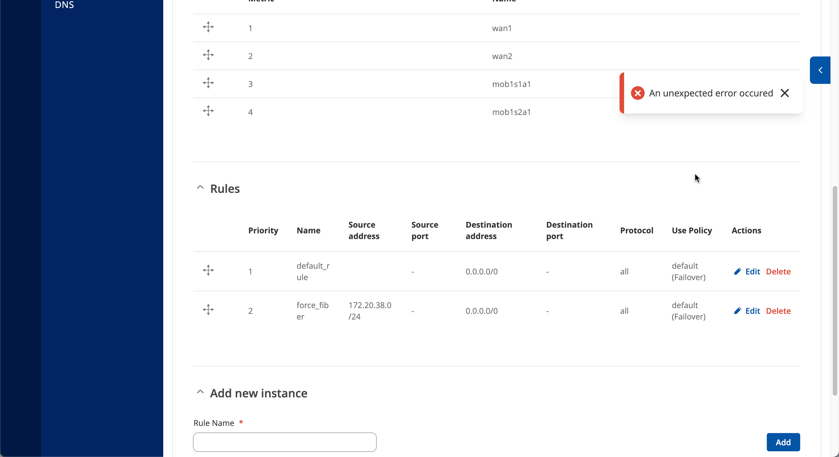

Anyone having trouble configuring mwan3 Failover on firmware 7.6.x?
I opened a support case on this yesterday but wondering if the community has experienced problems configuring the Failover (mwan3) page since upgrading to Firmware 7.6 (7.6.03 in particular). I am unable to add new Policies.
No matter what options I select on that page, I just get a “An unexpected error occurred” warning when I try to Save.

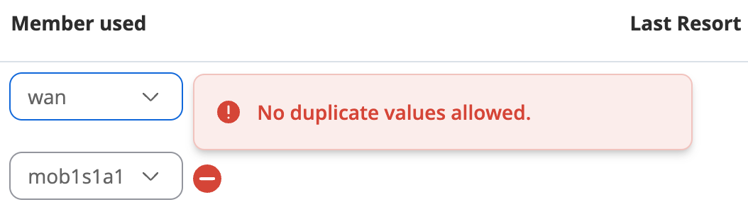

Also, the UX for selecting which interfaces should be utilized imo is very non-intuitive, and often just highlights in red with a popover bubble saying “No duplicate values allowed” but no indication of where this duplication is occurring or how to fix it.
Overall, this screen appears to be largely nonfunctional at least for me (Tested on RUTX11).
Hello @luckman212,
Indeed, there is an issue with WebUI when a second wired WAN is added to the failover rules/policies. The result is that these are not saved correctly. I have reported this issue to our RnD department and it should be fixed in the future firmware releases.
For now, you can try configuring it from CLI using UCI, for example.
Apologies for the inconvinience.
