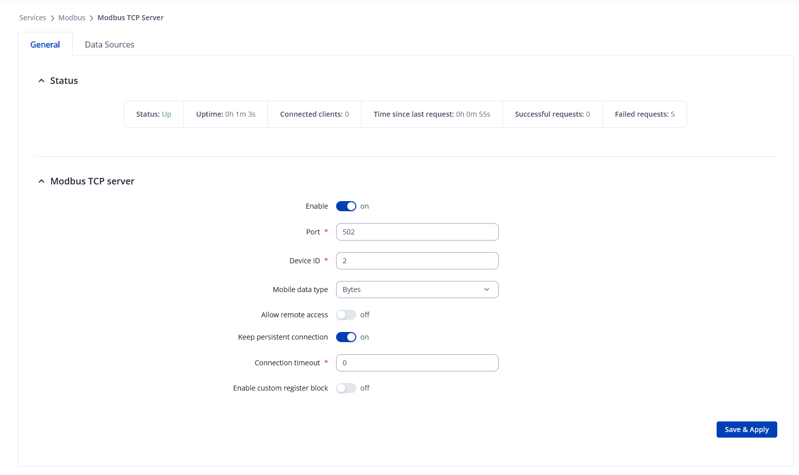

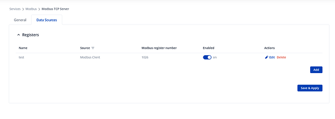

First TCP Modbus client, I read data from one device (successful).
Second, I started Modbus server and add one source from client to address 1026 next change address to 2000, function 4, with remote access and without.
Tried to read on Modbus Tester by PowerHud but still blinking : “Illegal data address“.
External IP internal IP, different function, no luck.
Then remove source, only empty server, this same situation.
edit: i have 1 client connected and Failed requests: 171
