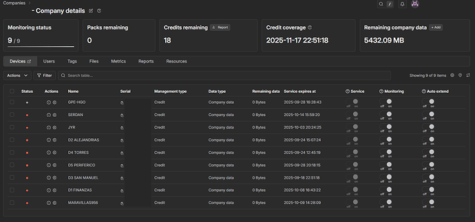

I have also confirmed that the RMS account has sufficient credits (my devices have always used the credit system, not license packs), and that the data plans are active (as shown in Image 1).

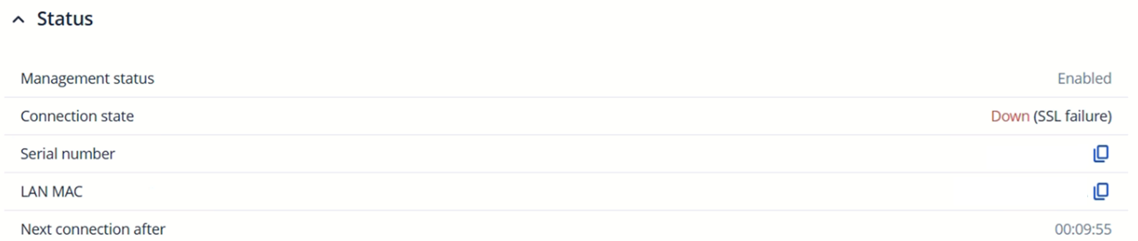

As you can see in the attached images, the connection error is “SSL failure”.

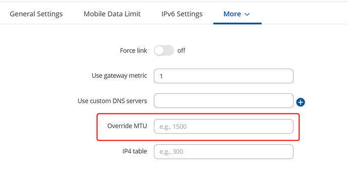

  • Finally, I want you to try to set a different MTU size on your mobile interface (you can try with one of the devices that are offline) to see if that improves the situation. The values you can try are 1500, 1480, 1420. As for where to change the MTU sizes, you need to head to the WebUI → Network → WAN → Click “Edit” on the mobile interface → Advanced settings tab → “Override MTU” option:

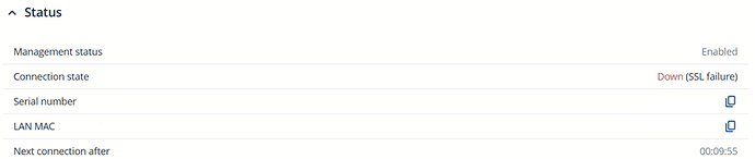

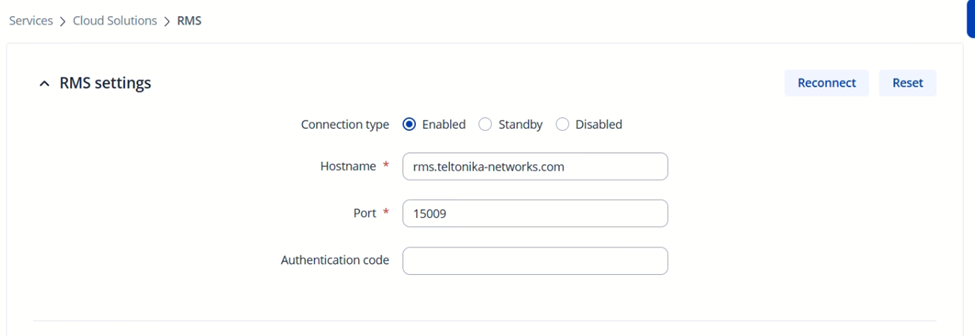

Services > Cloud Solutions > RMS > Status shows that the Management status is Enabled, but Connection state: Down (SSL failure)
When sending SMS with rms_status I get “Disconnected, SSL Failure“.
I also tried setting the PDP type in Network > WAN to IPv4 to no avail.

Regarding your MTU settings, could you try decreasing the value even further? You can decrease it in increments of 40 down until 1280. Let me know if this improves the situation.
