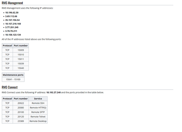

Not only the IP addresses, but also the ports must be whitelisted to avoid issues connecting to the RMS. Make sure you’ve added all the ports and all of the IPs found in the list here: What IP addresses and ports are used by RMS? - Teltonika Networks Wiki
Thank you for the reply.
I have noted the IP details from the Teltonika Wiki, which I need to whitelist all IPs with the ports specified in the document.
