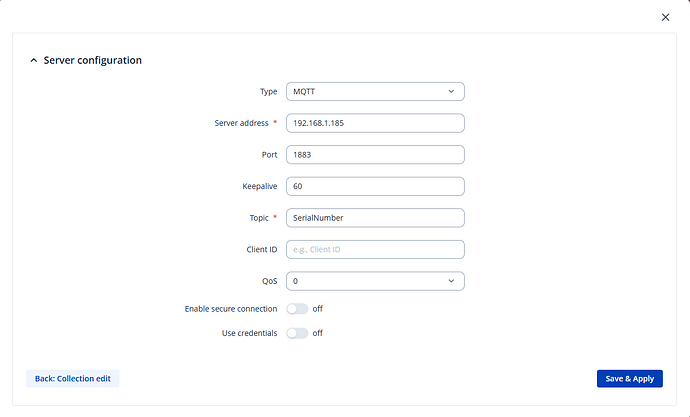

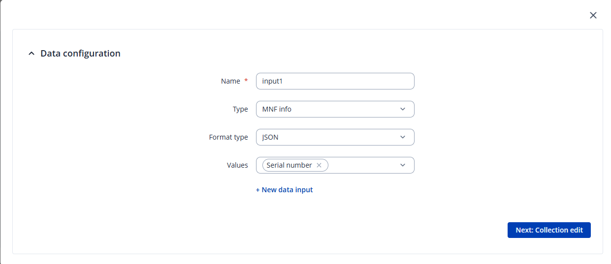

Using data to server you can configure which data are you going to collect: MNF info, GSM, GPS, MODBUS, etc. In your case we are choosing serial number.

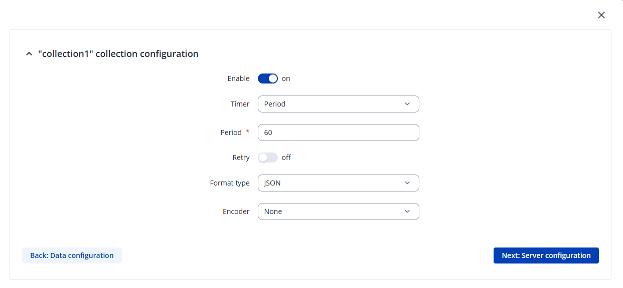

Then we need to set the period or schedule on how often the data will be sent.
Then we can select type as MQTT that defines the method which the data will be sent to server, define server address and topic. You can set your custom topic name.
Additionally, could you please clarify which broker are you using?
In your example the MQTT topic will be “SerialNumber“.

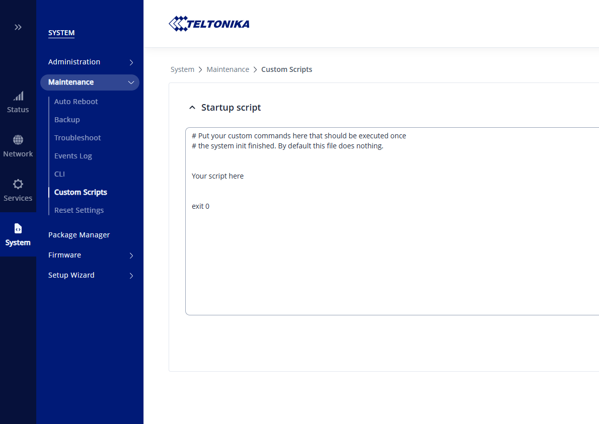

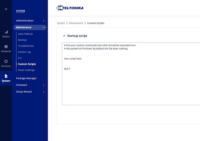

Additionally, you can create shell (.sh) scripts that execute when the device boots. To do this, navigate to System → Maintenance → Custom Scripts, and enter your script in the provided window as shown in the screenshot:
You can find several shell script examples in this article:
