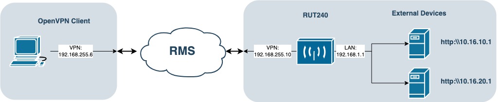

My scenario: The RUT240 is connected to the Internet via LTE. Several devices are connected to the LAN of the RUT240 and I want to access their web interface remotely. All devices in this LAN have fixed IP addresses.
According to the instructions in the wiki, I have gone through the following steps

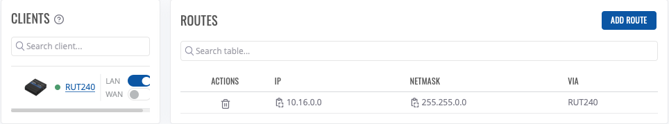

- add route: Manual - and then the address space of the remote devices
- restart VPN Hub, download VPN configuration
The VPN client is running, I can see the LTE router and the RMS user under VPN Hub → sessions. However, I am still unable to ping the remote devices or access their web interface. Something is still missing in this configuration.

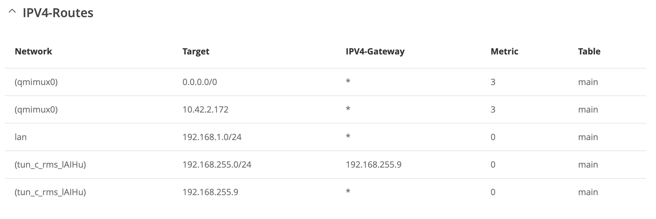

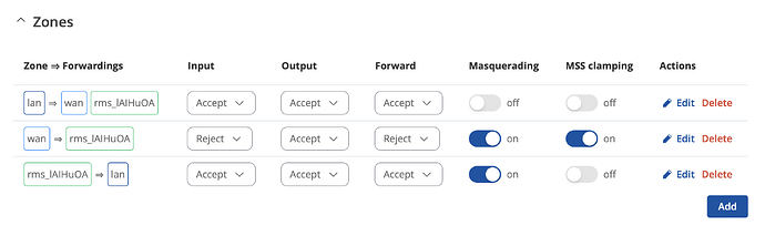

Here is my Setup:
This is the routing in RMS VPN Hub:

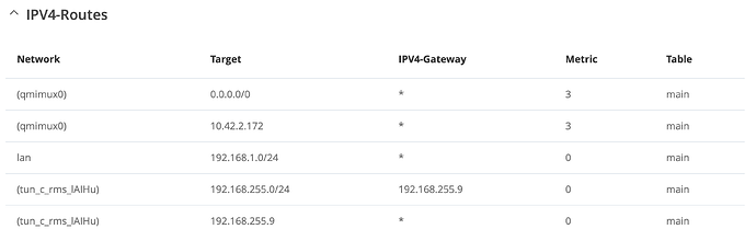

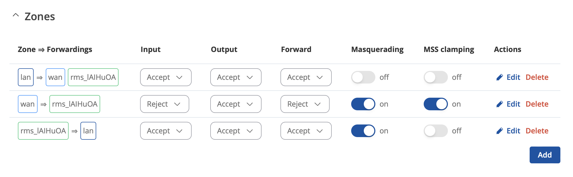

This is how it looks on the RUT240:
