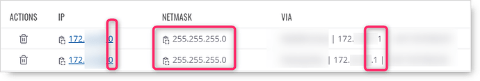

I am using a RUTX10 router.
I am using RMS to set up a VPN hub to access devices in the internal network.
This all works fine, but I only have access to the devices which I added in the ‘Routes’. However, I would like to access the entire internal network, and not only the devices I added as Routes. Woud that be possible? And if so, how can I configure this?

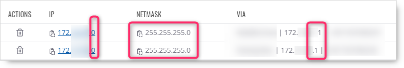

Your routes need to look like this.
.0 equals /24 and means ‘entire subnet behind’.
Yes, it’s possible to access the entire VPN client’s LAN network from other hub clients. There is a detailed wiki guide available here: RMS VPN Hubs LAN to LAN communication.
And as TeWe mentioned in routes, the last octec should be .0
If you need further assistance or have any additional questions, feel free to ask.
Thank for the support.
I can now reach the devices in the network, with only one Route.
I added a route manually, I used x.x.x.0 as IP nr, and 255.255.255.0 as netmask, as suggested.
