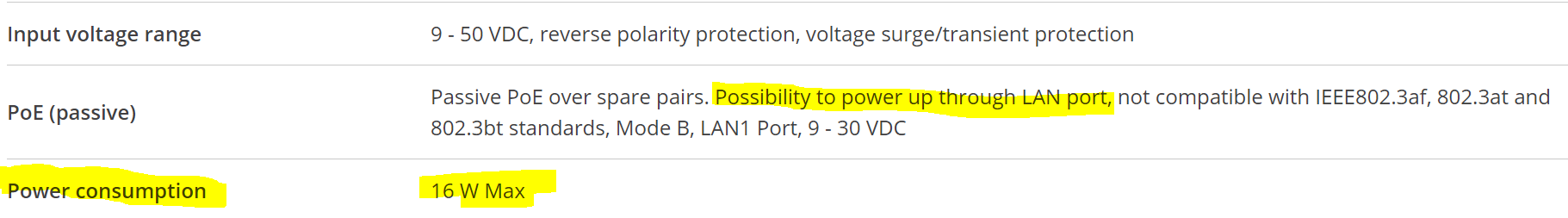

The APOE03GS PoE injector is designed to work with devices that support the IEEE 802.3af/at standard PoE power feed using Mode B (Pins 4/5 and 7/8). However, the RUTX11 router is not compliant with the IEEE 802.3af-2003 or IEEE 802.3at standards.
For the PoE part, it may work as long as power is supplied in pin 4 and 5
Please read this Wiki article on power options.

After reading the Teltonika wiki for the 5th time:
It is written that the RUTX11 may be powered by POE and it is shown which standards are NOT supported. But nowhere I can find which standard for PoE is supported?
So if I have good luck it is working and bad luck not?

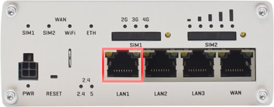

We have sucessfully used these convertors inline between the POE injector and the RUT. Instant PoE Converter, Indoor - Ubiquiti Store. They also do an external version which we have also used.
Be aware that you must only use Passive POE in to the LAN1 Port. DO NOT connect IEEE 802.3af/at standard PoE directly to any RUT device as it may destroy it this is known as active PoE and could deliver 48-56v to your RUTX11 which can only have a maximum 50v.
Using the convertor above this converts the Active PoE to Passive POE at around 24v.

RUTX11 power consumtion according to the specs on the Teltonika webside:
16W : 24V = 0,67A
(RUTX12 < 22W = < 0,88A in case of 24V)
If my calculation is correct I would need an inline converter which would supply around 34% more amps. Or maybe there is (hopefully) something wrong in my assumption?
