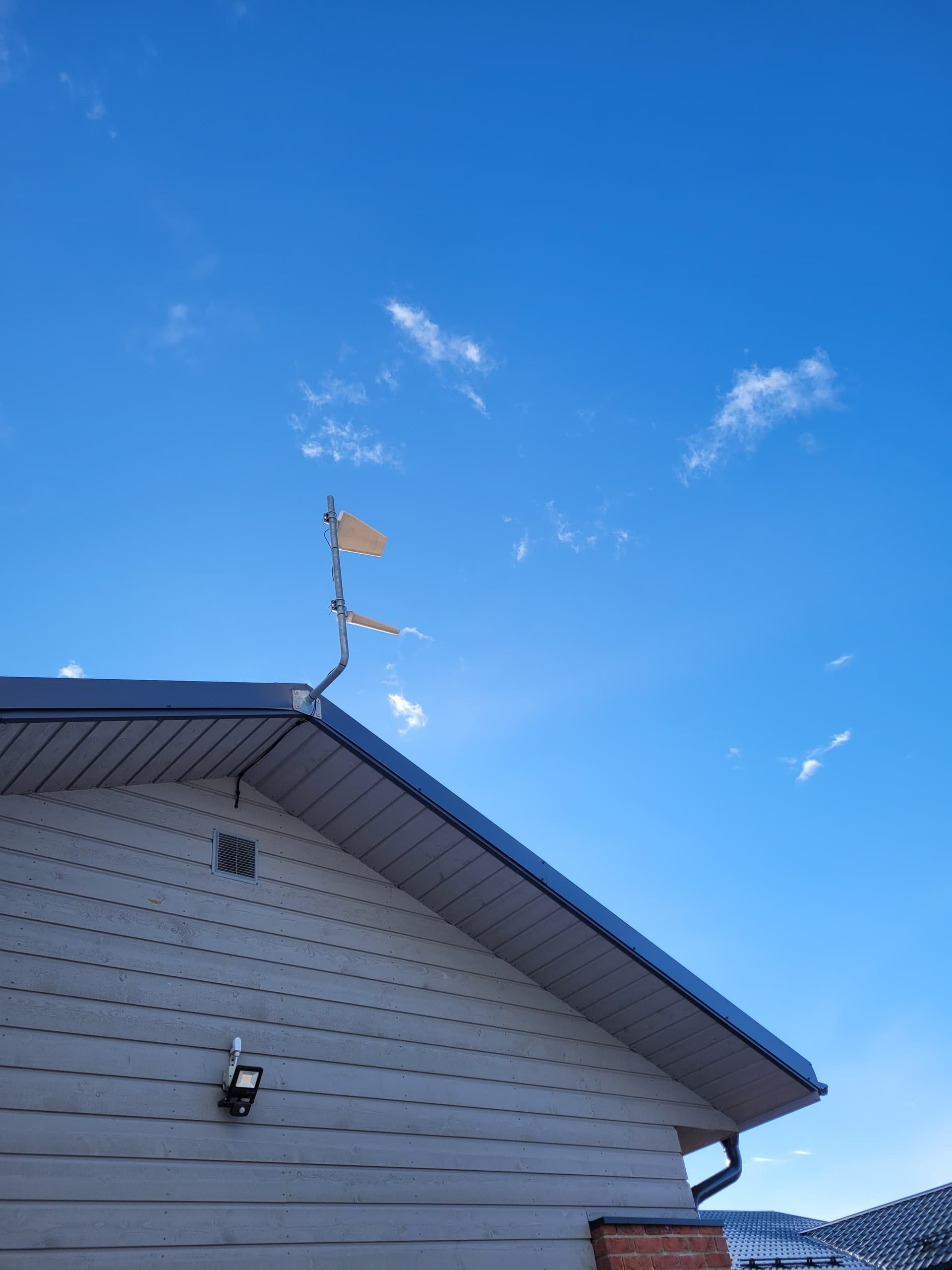

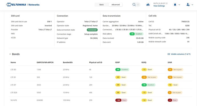

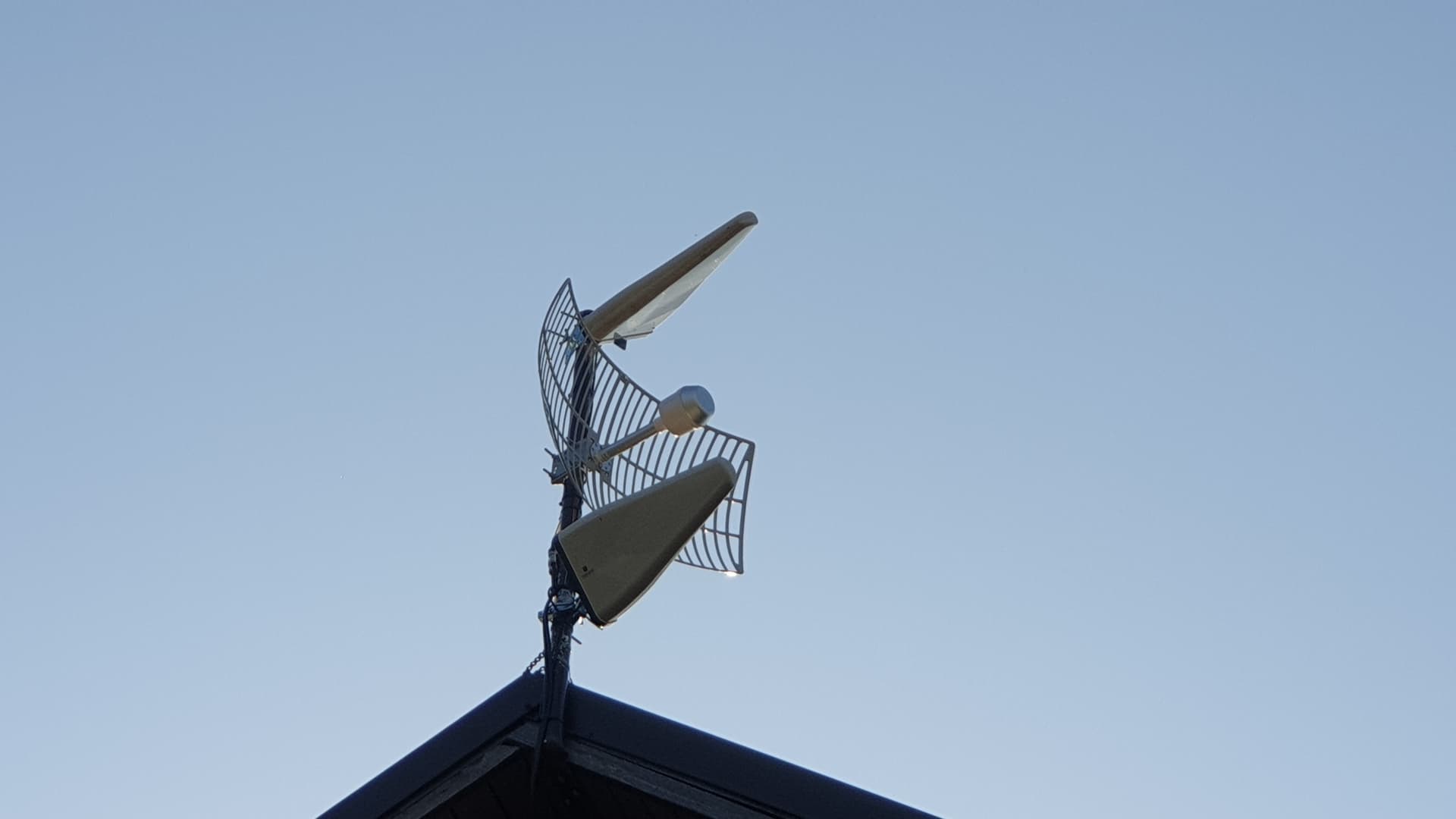

Can you please advise. I have 5G Telia SIM, RUTX50, directional 2xMIMO antenna that is on my roof pointing to the Tower. For some reason I am getting only 80-90 mbps speed which for 5G is unacceptable. Am I missing something in settings? (Default settings at the moment). Also I see in mobile network settings 100MHz Bandwidth (5G N78) that has poor signal, is it because of this maybe? I used https://www.cellmapper.net/ but all Telia cell towers around do not have 100 MHz bandwidth (in Klaipeda Tauralaukis region). Please advise. Many thanks

Based on the information you’ve provided, the SINR value for both N78 and B28 bands is showing as 0, which suggests that the tower cells are quite far away, resulting in moderate interference and noise along the signal path. This could be a key reason why you’re experiencing slower speeds than expected.
Please ensure that your antennas are properly screwed in and securely positioned, as loose or misaligned antennas can negatively impact signal quality.

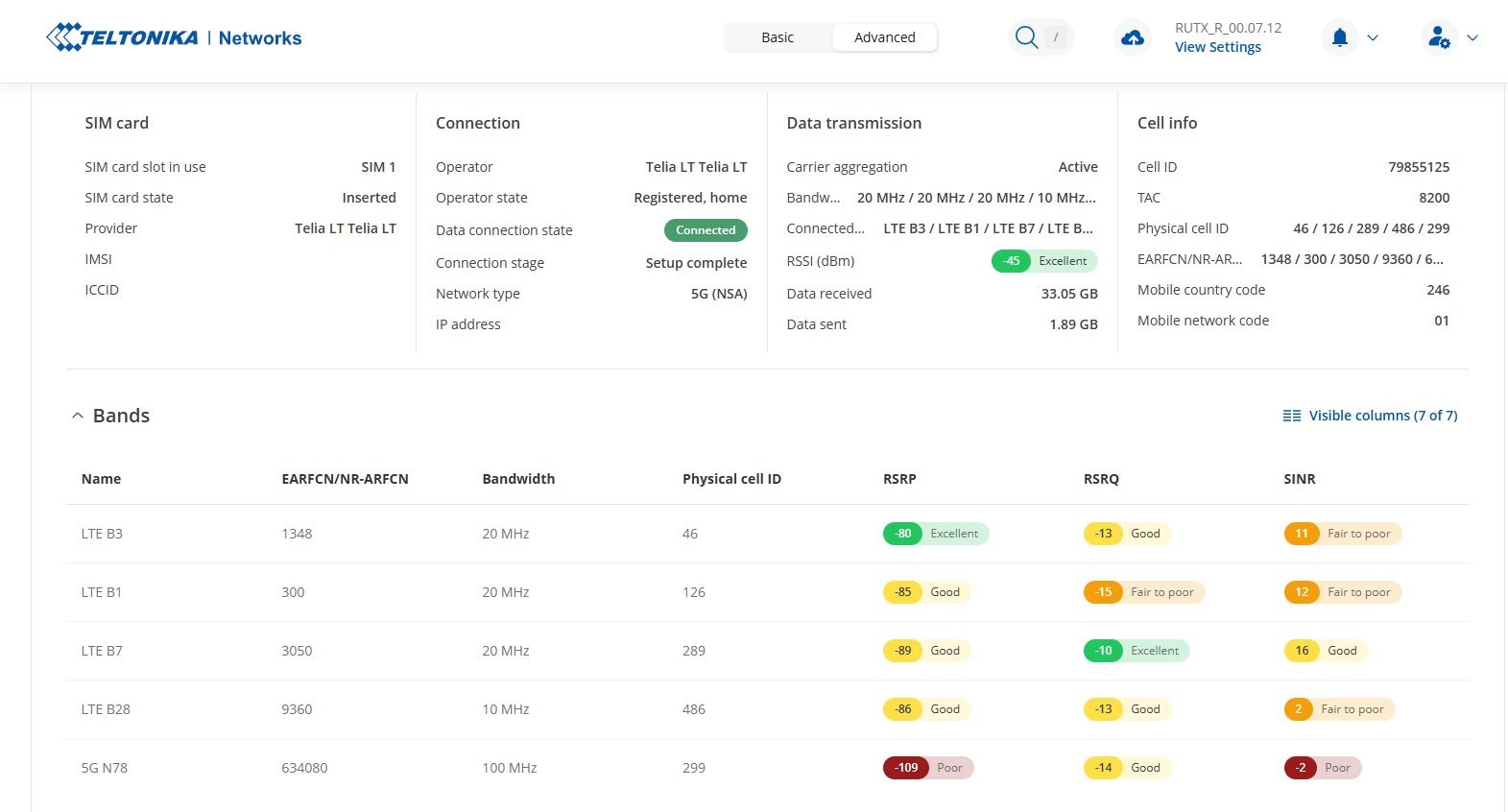

Could you also provide a full screenshot from the Status → Network page? Please ensure that any private or sensitive information, such as IMSI numbers or public IP addresses, is hidden for privacy.

Thank you for prompt reply. I tried to set as only 4G and it even worse with mbps. Maybe I should concentrate on frequencies of the actual tower my antennas are pointing to? I could maybe try do manual Band selection? I also tried to switch around antenna inputs so at the moment MIMO antennas are to antenna 1 and antenna 4 ports, middle two with small antennas. Antennas are properly screwed. I am not sure on witch Band I should concentrate as when I move around MIMO antenna on ports it makes different on different Band RSRP, but speedwise it does not make much difference tbh. On the 5G/LTE map I am in green 5G area.
I attach my area location circled in red and the tower that antennas are pointing to. And as you have asked full screenshot for status.

Can you show how antennas are screwed on RUTX50? Have you tried to perform testings with standard antennas (outside the building)?

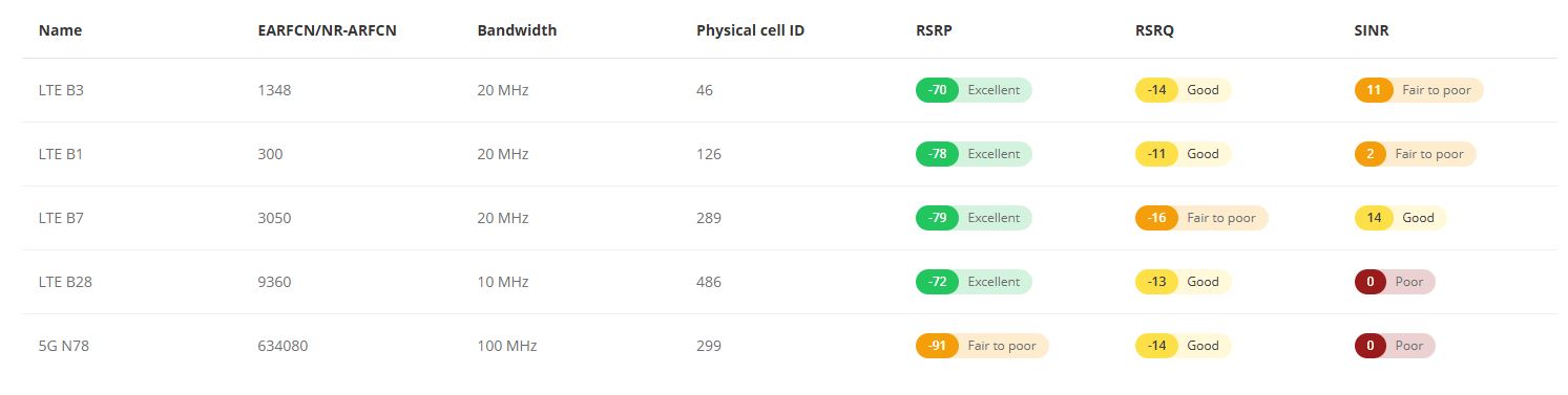

Hello, I guess you want to see if antennas are properly screwed on, but I asure you it is and np I will provide with some pictures. So today did some testing with original antennas inside and outside the house, also screenshots with swapping around MIMO connections. See screenshots below. By the way, with my Samsung S20 FE 5G, just sitting in the room I get 200 mbps in speedtest, so don’t get it why same provider in same room in this router gives me only 80 mbps…Maybe android inflates this number? :slight_smile:
Inside the house original antennas:
Outside the house original antennas:
Outside the house other side original antennas:
Garage with MIMO connected to 1-2 slots:
Garage with MIMO connected to 2-3 slots:
Garage with MIMO connected to 3-4 slots:
Garage with MIMO connected to 1-4 slots:

Also, it’s not good to have mixup of antennas. As I see in the photo, you are using 2 standard antennas and other connectors are from 2xMIMO antenna. This could be the reason of speed loss.

Thanks for the info. With original antennas speed was at that time around 60-80 mbps inside or outside the house. So since antenna mixed up is not good, I have removed original antennas and left only directional and so far I get best result 90-100 mbps.
But your directional one have only 2 connectors and for full performance you need 4 of them

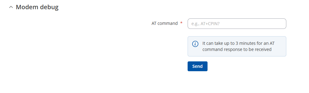

This issue could also be caused by congestion on the lower frequency bands. Could you try locking the device to use Band 7 as the primary by sending the following command in System → Maintenance → Troubleshoot → Modem debug:
AT+QNWLOCK="common/4g",1,3050,289
Where:
3050 - LTE B7 EARFCN;
289 - B7 cell ID;
All other bands should still remain as secondary. Keep in mind, that this command only works until the next modem reboot, but if this helps with speeds we can try automating it to be applied on each modem reboot.

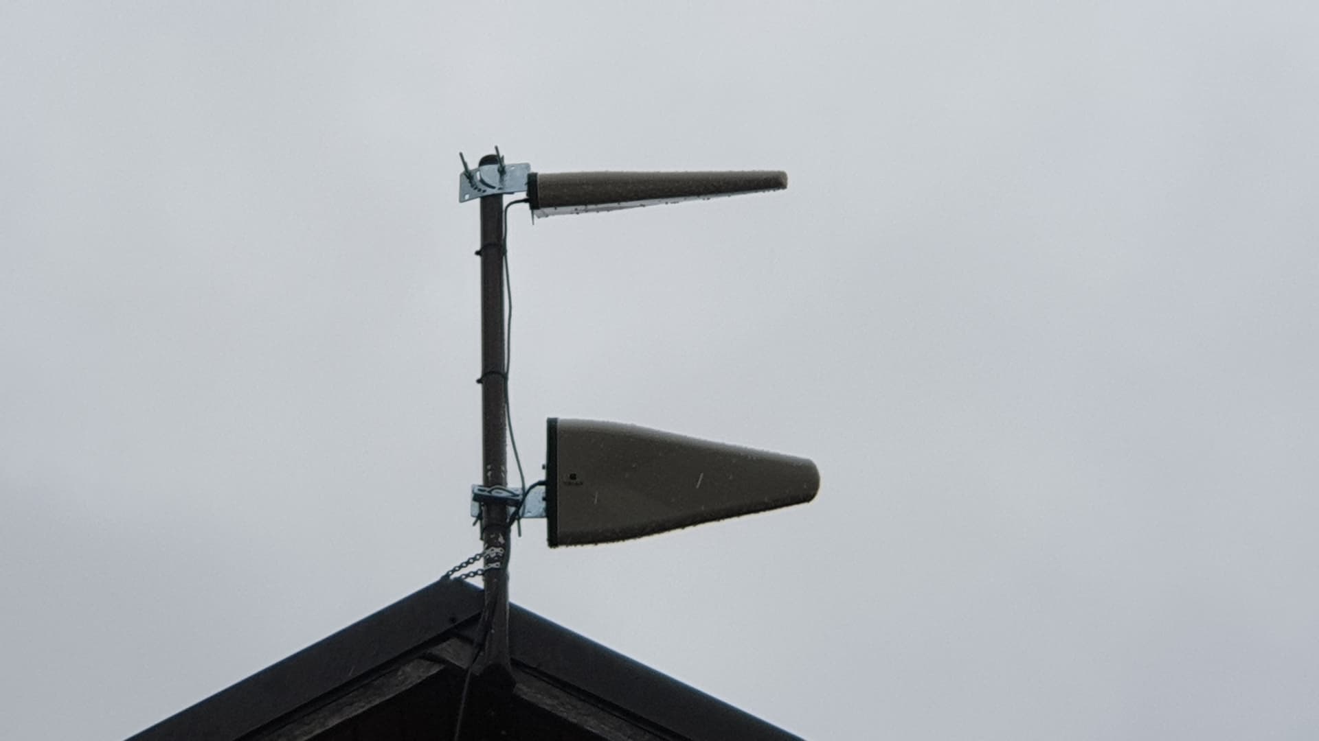

Somebody in this thread suggested your external antennas could be case…
Nonsense. If supplier can confirn antennas meet the spec so would look for something else. I had pretty much the same external antenna settup before and managed to get 840mbps download and 160mbps upload.
Router 1 and 4 antenna ports are the main ones so I plugged external antennas to these ports.
2 and 3 ports were used with indoor antennas.
I do not get those download/upload numbers now unfortunately even my antenna setup is better than prior. Router receives very stable strong signals. But I have slower 550 download speed now. Upload however is up to about 160mbps but fluctuating and I am not sure whether its a tower or rutx50 firmware problem. Can be a router and I will explain why.

This kind of antennas setup (the one which Zavista have) is not a nonsense, it’s not good when have mix of different antennas.
For your problem - did you try 7.12.3 firmware?
I tried many things
Please, can you support your statement antennas are not good?
I can support mine based on my own experience having very similar settup as Zavista has now.
This is what I have now.
I discussed with a big antenna supplier if my settup is correct and will not cause signal interferences and connection quality. They said no. Those guys are not jokers they specialise in radio frequencies and they do get in contact with Teltonika.
