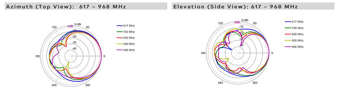

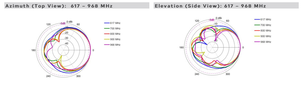

@Matas Hi M, I believe that @nodesolutions is requesting:
a) Radiation patterns (example below) - these patterns are normally standard documentation and are produced covering several bands, to address your comment of “… it will receive different signal strengths or speeds depending on the quality of the band”. If Teltonika don’t have these, then the manufacturer you use, should have.
b) The second question is asking … Is the antenna designed to be ground plane independent?
Regards … Mike
