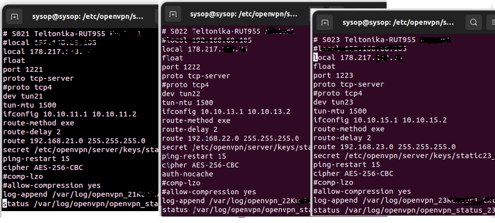

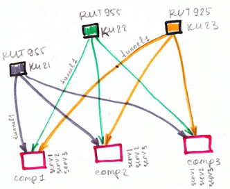

I have 3 routers RUT955 (KU21,KU22,KU23), every router have 3 openvpn tunnels (client mode, static key), every tunnel is connected to 3 different comps. (comp1, comp2,comp3, see pictures).
On every comp the openvpn server is UP (serv1,serv2,serv3 - for each tunnel).

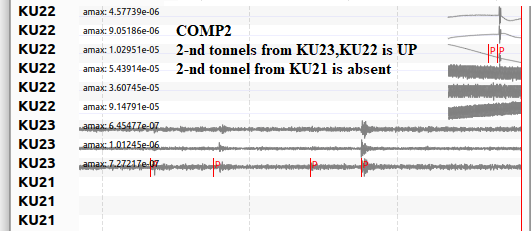

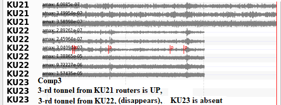

Every time after automatic router’s reboot on each router only first tunnel is UP and are working (almost always) on 1-st server, second and third tunnels is working one by one or periodically, or working only 2-nt tunnel, second and third tunnels is not UP. It happened on all of 3 routers.
comp2
Снимок экрана от 2024-03-29 11-09-20
Example of configuration of openvpn servers (for 3 tunnels) on comp2.
What can you say about this problem? Is it possible to have the openvpn tunnels always running at the same time?
