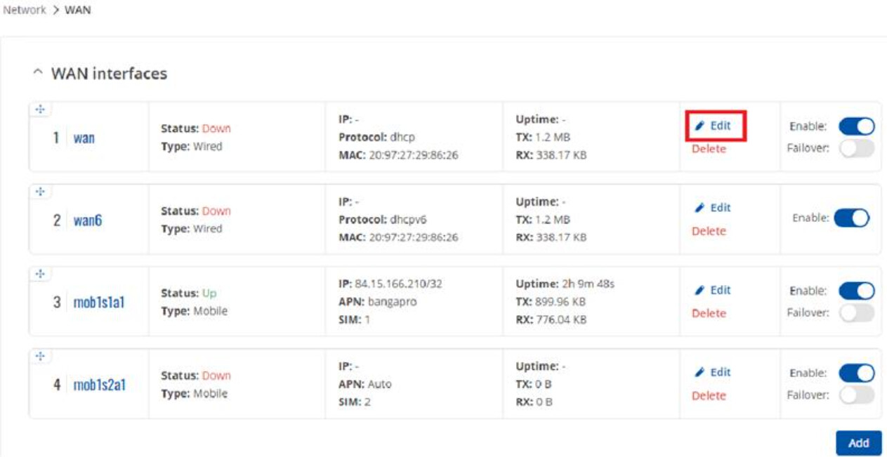

For rut1 (RUT951):
  1. In WebUI Navigate to Network → WAN → WAN interfaces and under wan press “Edit”

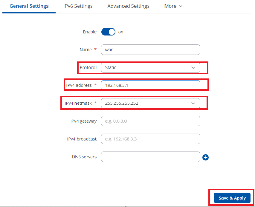

  2. General Settings:
  • Protocol: Static
  • IPv4 address: 192.168.3.2
  • IPv4 netmask: 255.255.255.252
  • Press “Save & Apply”

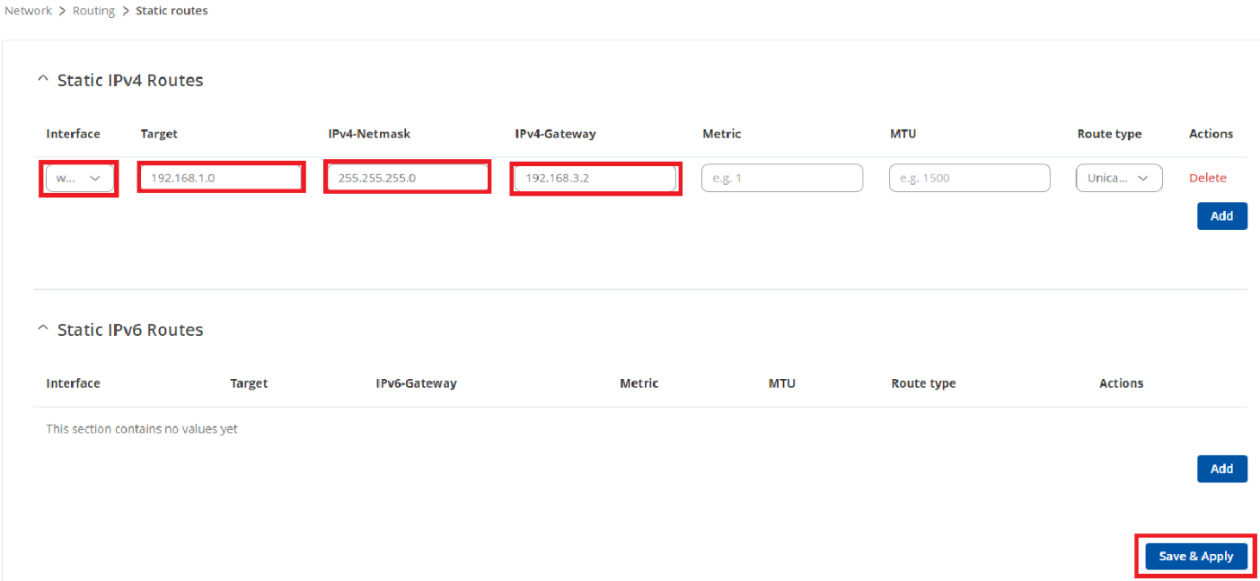

  1. Navigate to Network → Routing → Static routes and under Static IPv4 Routes press “Add”
  • Interface: wan
  • Target: 192.168.2.0
  • IPv4-Netmask: 255.255.255.0
  • IPv4-Gateway: 192.168.3.1

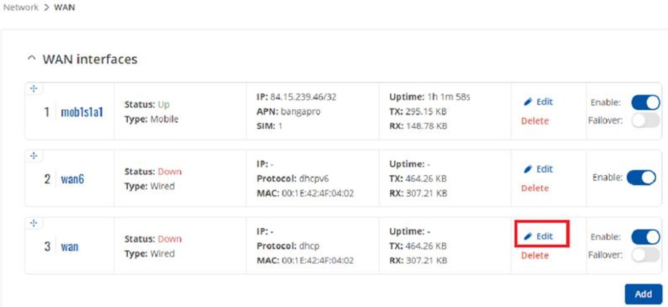

For rut2 (RUT950):

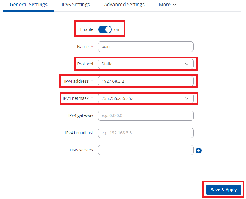

  1. In WebUI navigate to Network → WAN → WAN interfaces and under wan press “Edit”
  • Protocol: Static
  • IPv4 address: 192.168.3.1

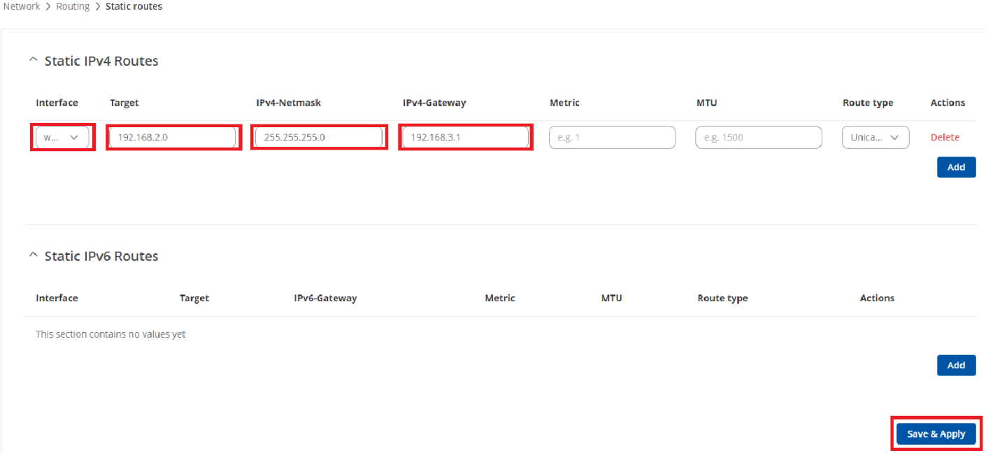

  • Interface: wan
  • Target: 192.168.1.0
  • IPv4-Gateway: 192.168.3.2
