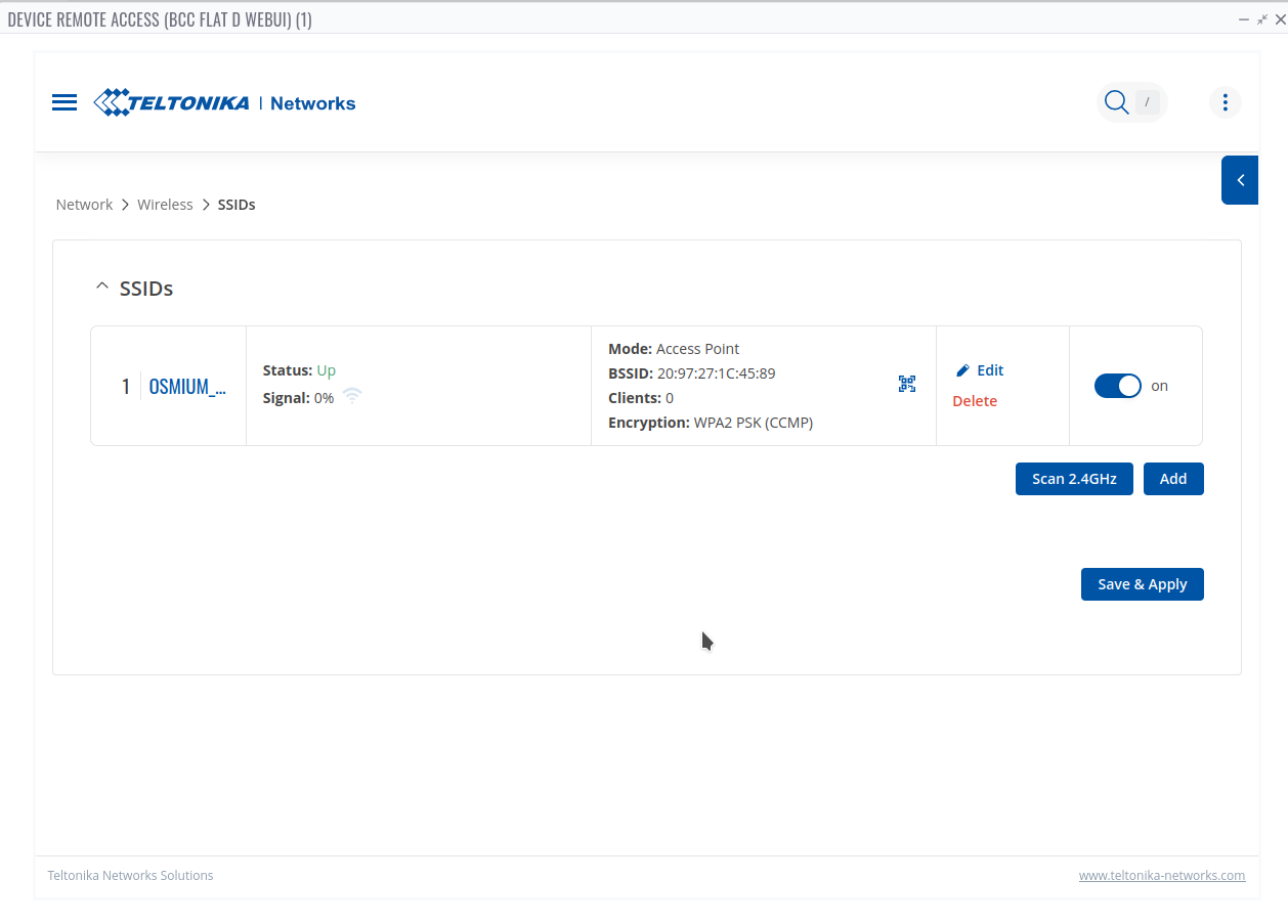

Hi, we have two RUT200 which on the WebUI, Network > wireless > SSIDs display our one SSID with Status Up and Signal 0%. We expect two clients, but none can connect.
screenshot above

When no clients are connected, the signal isn’t calculated by default. So, in this case, everything seems to be functioning correctly. The problem may lie with the Wi-Fi connection of your ESP32 devices. However, it’s strange that only one of your boxes isn’t connecting. The antenna shouldn’t be making such a significant difference with devices situated this close. At this distance, they would likely connect even without an antenna at all.
Can your devices detect the RUT200 Wi-Fi network SSID? Can they establish a connection to it, or neither of these?
